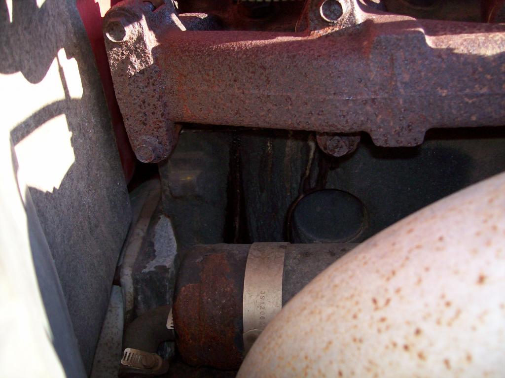

I've been loosing coolant for a couple weeks but hadn't found any drips or leaks, until last Sunday when I was finishing up a transmission service. Looks like it's coming from between the head and block at number 6 cylinder. I doubt torquing the head is going to help at this point. To add insult to this injury, today the PS gearbox started leaking from the input end and the large "nut" on the end is so corroded I doubt I can just put a new seal in. I'm driving the "brick" 130 miles a day for work and don't have a backup! Yeah I know I'm whining, but this sucks.
So the minimum I'm looking at is a head gasket and maybe resurface the head? I've dealt with PS problems too many times so I know what I'm in for with that.
Then there's the transmission heat expansion tank. Are those still available? What about the hard line at the back of it? I don't know how badly rusted the tank is until I can pull it but the hardline is severely corroded.

I wouldn't say "maybe" to resurfacing the head. It's going to need it. The exhaust side especially. Make sure the valves are re-ground as well to maintain the proper valve recession.

No chance the head isn't warped? what's the right head gasket. Napa sells FelPro and there's different thicknesses available. Probably the right time to reseal the tappet covers. Replace the head bolts? How many bolts and studs should I expect to break? May be time to replace the injectors, mine are the never serviced originals.

That's the exact same place mine let loose at. I had the head milled, got a thicker gasket and a Cummins upper gasket kit.
I put manifold studs in while I had it all apart.
I'm worried that my cooler will be the next to go too. I'd have swapped it while I was doing the head but the fittings were pretty rusty and I didn't want to tear up any more stuff.
