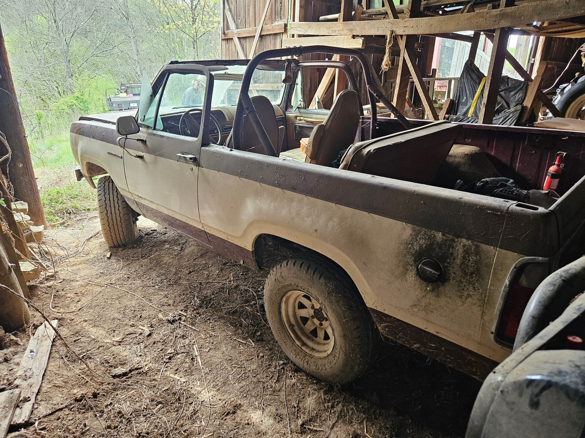

This weekend was productive! Been slowly cleaning up the farm since my dad passed away in '24 and after the historical flood of '25. This weekend my brother and I determined to get his '78 Ramcharger started and out of the barn so we could get to dad's 1993 Club Cab W250 CTD with the Getrag and 125,xxx miles on it that he bought new in '94. The only new vehicle he ever bought in his life.
I've lived in these river bottoms since 1971 and the back water never got into our tobacco barn until last spring. It was over the axles and just an inch or two shy of the top of the wheels. The barn sits on a high spot so once they re-estimated the crest (for like the 10th time!) it was too late for us to get anything out of the barn as access was already gone under 10-12' of water. So everything got wet...
With a new battery in the RC, I poured gas into the carb top to fill the bowl and some down the throat. The key just clicked and jumping the relay didn't do any better so we figured the starter had rusted up. I had a new one in the box as a spare for my M880 so we bolted that one on and after spinning over a few times it fired up and purred. Added 3 pints of tranny fluid and drove it out (had to keep refilling the bowl).
Next was dad's CTD! I disconnected the FSS and with a new battery spun it over a bit to get the oil circulating. It was last registered in 2014! After I topped off the master cylinder I reconnected the FSS and it fired right off just as if it had been run the day before! I drove it out and then into the barn by his house (which is a little higher) so we can work on it easier. The brake/anti-lock light was on and the fuel gauge wasn't working. I need to check all the fluids, add more fresh diesel and clean it up real good before driving it much.
Next will be the '73 Duster still in the barn...
I have pictures but can't post unless someone volunteers to let me email them to them.

KRB, I will be more than happy to post your pics for you, I sent you a private message with my email.

Some pics from KRB, sorry I couldn't get my gmail to open the 2, I believe vids you sent. Any more pics Kevin I will be glad to post them as everybody likes truck ****
