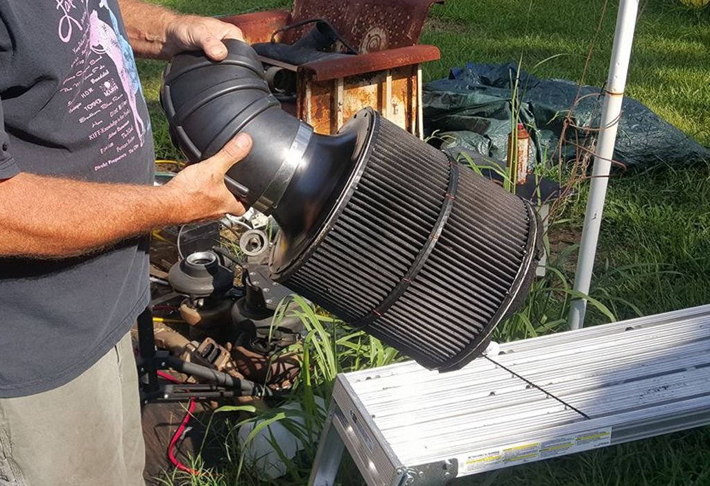

Two 5"-to-6" 90*ELLs turn into a 6" Tee, that turns into the Stock-Pot cold-air intake.
Start with custom BHAF:
Put it in a true cold-air intake that can breath:
And tie it into the spinny-things:

THD recently started selling this. I heard about it on Facebook.

Not sure is the benefit of $-per Horsepower would be worth it for me. Besides his is ugly as sin. This filter is a little smaller than the THD BHAF filter. I got the sock and filter (originally for a 2nd gen) for $45 new off craigslist. The tube and elbow off Amazon after watching Decent Garage on a home pieced together BHAF. I shot clear Cerakote on the tube. It was already polished.

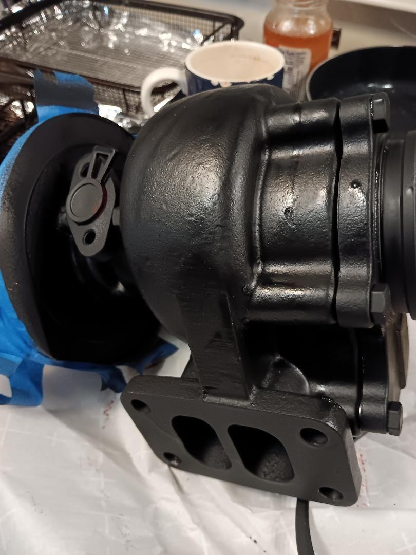

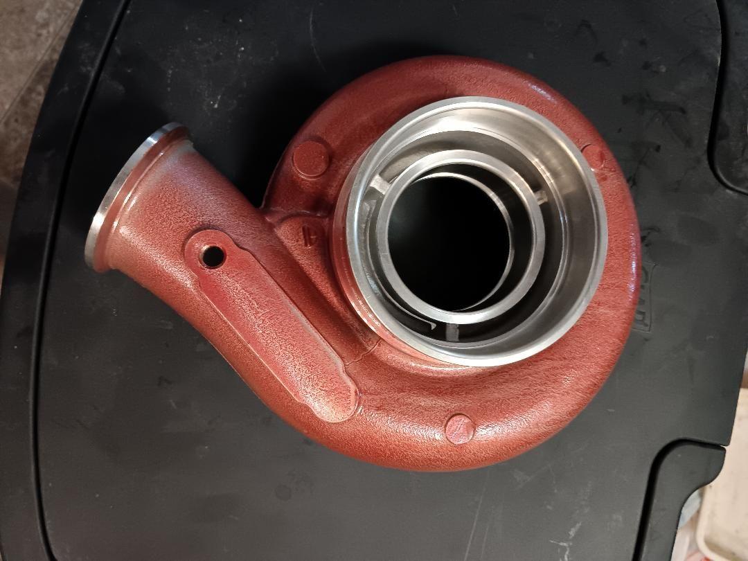

Glacier Black on the hot side supposed to go 1600* The intake is about good to 360*. I had to bake the compressor in the oven. My oven still stinks. I was expecting dark red like the elbow. I used all the red pigment.
DAP Billet HX35 Stage 1 Turbo up to 450HP 62mm Compressor with 64mm Turbine
