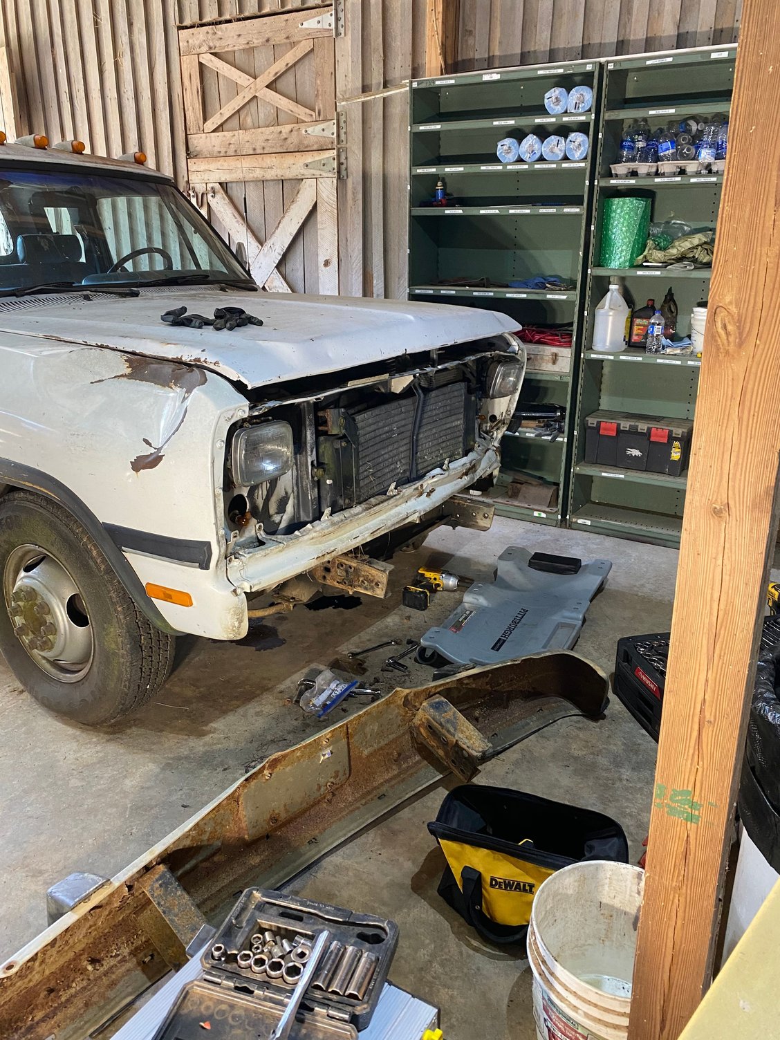

Put a nice original headliner in the blue/silver truck and replaced the broken rear sliding glass latch. Starting pulling the front off the white D350, plan on replacing the bent core support, fenders and hood!
