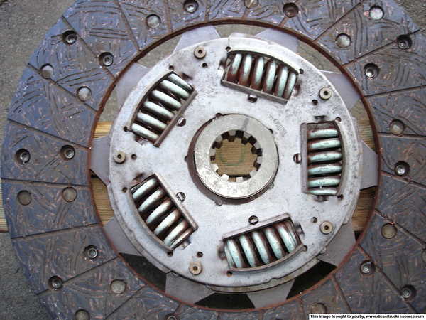

Ok, found out from the Valair website that the 2nd gen flywheels are all 12.25". All 12.25" clutches for 88-05 cummins work as long as it wasn't the HO (which had the NV5600 6 speed). I can put on the 1st gen 13" flywheel, but there are not as many clutch options it seems. For 12.25" flywheels there are way more options at least through Valair. They seem to have much more managable prices than Southbend.
Also found out that the OE replacement (not button type I think) for the NV4500 is good for "300hp and 700ft-lb". I think I'll be going with the midrange option. From the site:
Attention all 12-1/4" NV4500 users
... You no longer need to upgrade to a 13" clutch, with our new HD Spring Discs you will never have to worry about breaking the clutch hub or springs like on the OE version. The new 'Floating' designed hub minimises clutch rattle when idling in neutral with the clutch pedal released. Avaliable in Organic Facing, Ceramic Button, Kevlar Button and Kevlar/Ceramic Button.
Old Jan 24, 2010 | 04:42 PM
wannadiesel's Avatar
Posts: 22,594
From: New Holland, PA
Please don't waste money on a 12 1/4" clutch. The centers are fragile and prone to breakage from 1st gen bottom end torque.

Dave, is this including these "button" type from Valair? I have to machine out a groove for the inner 7" of diameter of flywheel because they have a thicker section in the middle of the clutch.
Anyone know about these upgraded 12 1/4" type clutches? Am I doomed to get a new flywheel as well?
Old Jan 24, 2010 | 06:06 PM
Posts: 22,594
I looked at it and it looks somewhat better designed than the 12 1/4" Con-O I had that broke.

Someday perhaps. As of now my only foreseeable tows will be a lobsterboat twice a year. Anything other than that probably wouldn't add up to more than 7-8,000lb or so I'm guessing.
Did that blow on you when engaging or when engaged?
They wrote on their site that they have upgraded the 12 1/4" clutches so the 13" upgrade is no longer needed? However, I am a bit ignorant on these issues untill my recent research. So I have nil experience and appreciate all input!
I don't know when it broke, it just started making bad noises and vibrating like I had lunched the input shaft bearing on the trans. I was relieved when it turned out the be the clutch. Truck was still driveable, the clutch never slipped.
