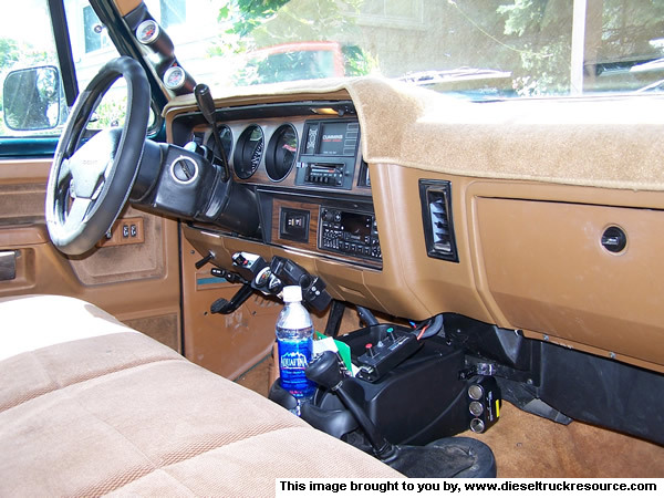

Take some pics and show us where you put the controller. I still haven't mounted mine permanently yet, as it's hard to find a suitable location with all the gauges/accesories I have. Here's where it is for now...

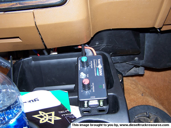

Thus far I'm thinking to putting the controller in the dash above the glove-box. I'm under the impression that, once set, one shouldn't have to fiddle with it. I'm currently thinking a simple Arm/Disarm switch will suffice.

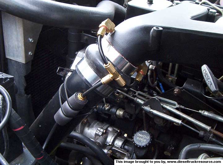

Back to the question. Likely you will need both nozzles. I would start with the single nozzle PRIOR to the Y. If that is not enough cooling, I would tee the 2nd provided nozzle across from that.

I ended up installing the injectors top and bottom of the intakes inlet. My thinking is that if there's any weird airflow due to the twists and turns of the ductwork, having the injectors as they are help eliminate more mist going to one branch as compared to the other.
The bottom injector is rated at 15gph while the top injector is rated at 6gpr. The check-valve is located on the charge-air pipe just below the injectors. (I've wrapped it with foam insulation tape so that vibration won't be an issue there).
Running a 55/45% mix initially presents as though I could make that top injector larger. . . . . . . .
Thanks for the input folks.
DOH! I see a loose screw in that fan shroud!
Don't worry, your tire will pick it up for you if it falls out
Everything looks good on the WM setup

The tank mounting looks great! Where did you mount the pump?
EDIT: D'oh, I see the pic of where it's mounted now. Very nice and clean install!
