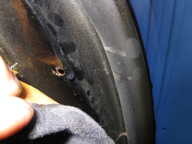

I've been trying to figure this out for awhile, and I can not find how the water is getting in.
Here are a couple of pics of the result, and where I see the water collecting and dripping
I don't see any visible cracks, around the outside of the cab. The windshield appears to be water tight. I hit it with the hose and no leaks.
The water collects here at the front only when the truck is parked facing down a hill, like when I back it into my driveway.
Where is the EDIT water getting in!
Attached Thumbnails Water leak: passenger side-floor-water.jpg   Water leak: passenger side-screw-1.jpg   Water leak: passenger side-screw-2.jpg

I'm sorry, maybe the photos aren't very clear. The first one is of all the water in the floor, the other two are from the header where the sun visor mounts. The photos showing the hole are where the screw holding the plastic header trim mounts to. The water is dripping from the ceiling not coming in from the floor. It does this when it's parked in my driveway.

It's not from the doors as it is coming from the roof, and from the screw hole that the head liner screws into. So the water is between layers of sheet metal.
I don't think it's the external drip rails.
One of the first things I did was to flood the drip rails, and leave it for an hour, and no leaks.
