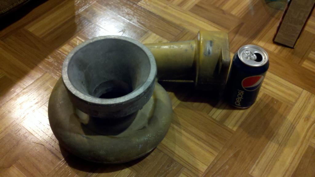

Couple of questions. Assuming (hoping) nothing breaks on my truck in the near future, I'll be getting all of the parts for the twins within the month. So far I have a primary off a cat 3406. It has a 72 compressor and a 88 turbine with a 1.32 a/r. The price was right at free-ninety-nine so I picked it up. I also have begun to fabricate the hot pipe using schedule 40 3 inch and I'll be cutting out my flanges tomorrow. I figured my primary turbo choice should be a decently spooling setup since i'm only running 5x.014s.
I was wondering how much boost there is between the primary outlet and the small turbo inlet. My turbo has a goofy flange on the compressor outlet. Instead of dealing with finding the matching fitting, I figured I could cut the end of the flange off with a hacksaw and simply use an intercooler boot instead of the traditional vband with o- ring

You could see upwards of 40psi between them. I would weld a few beads around the outlet of the housing so the hose won't blow off.

Cut the ears of the flange as close as possible to the housing and then grind flat with a flap wheel. That should save you some room on the amount of area which the hose has to clamp to. If you end up needing it you can always add a strapto keep from blowing boots.
