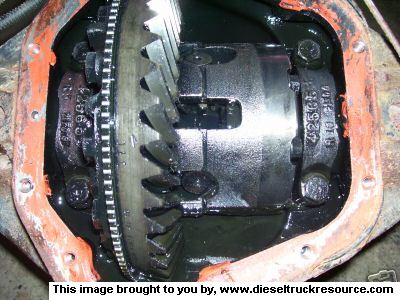

Here's a powr-lok.
and an open carrier

DEFINATELY an open carrier in mine.....
Hmmm....... Detroit or find a powr-lok.
What powr-loks will fit the D70? Is the 60 and 70 interchangeable?

I'd go with the powr-lok. There are quite a few out there on ebay and such, or you can get new ones, but they are pretty pricey. Not sure if the 60 and 70 are the same.
