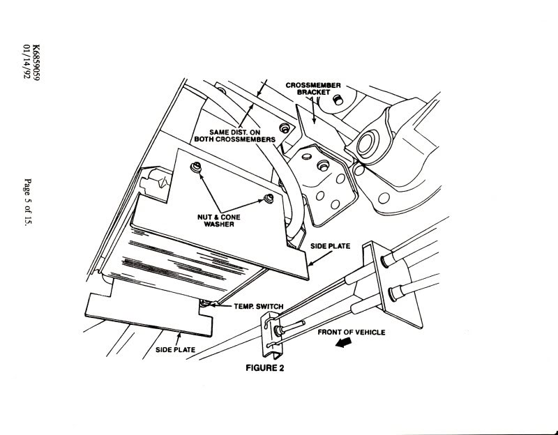

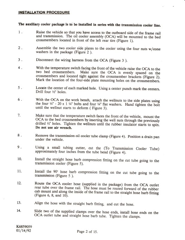

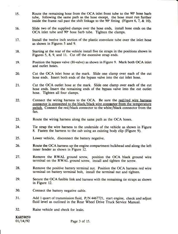

Post Super Duty Transmission Oil Cooler
Here is the Factory Install Manual
