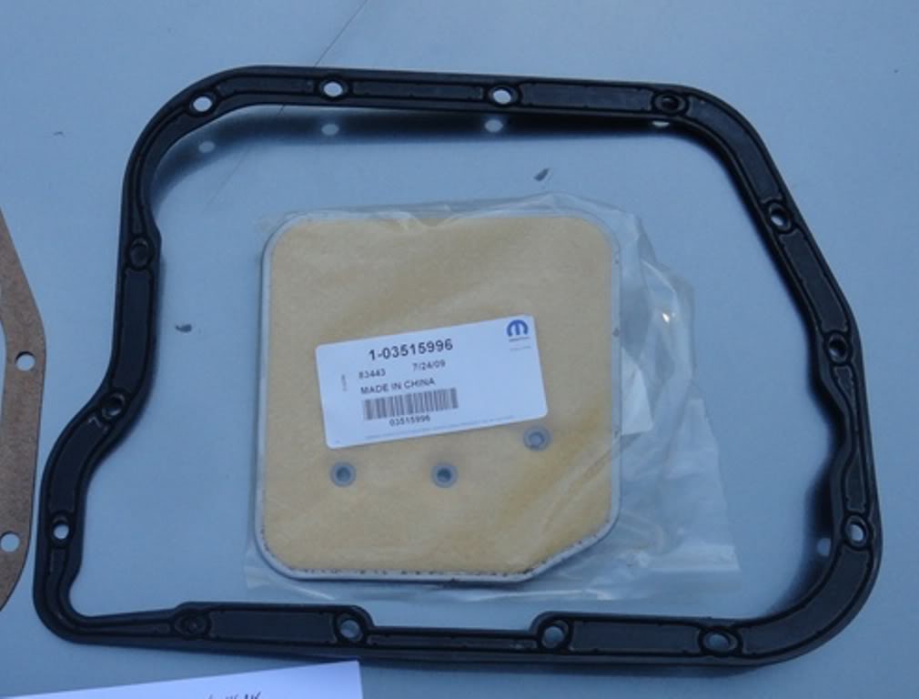

For anyone who actually hasn't seen one of these reusable gaskets
And the Mopar filter.
I paid $20 for the gasket and $8 for the filter. The OEM filter seems really heavy compared to the aftermarket ones.
Don't know why.
T.
