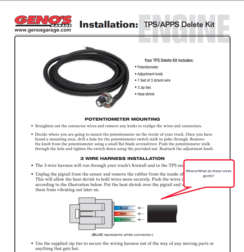

My question is are you able to install a TPS delete kit (potentiometer) on a non lock up A518 transmission (2 wire) out of a 1992 w-250?
My application/truck is a early 1991 w-250 it originally had a 3 speed 727. During the restoration of the truck I found a A518 non-lock up transmission for a good price and installed it. My plan was to just wire the Over Drive to a switch on the dash.
I've seen these TPS delete kits from Geno's and other places for a reasonable price. An I thought it might be nice not to hit a switch every time. But...The TPS delete kit looks to have 3 wires and plugs into the TPS wiring connector. I don't have either, I only have the pig tail coming out of the trans with two wires. So will the TPS delete work? Does anyone have a wiring diagram of where the OEM TPS wires go? Or a wiring diagram of a TPS delete? so I can come up with a game plan if no one has done it before....

Without looking at my truck, and it's been a while since I've dealt with the TPS, I can't remember how many wires but it does seem like only two. And it is possible to run a potentiometer on the A518 for OD but I assume this is for a different application? Not being a transmission guy (there's a few members here that are really good at that stuff) I couldn't tell you how to wire it up but when I used a potentiometer it seems like I just used the two wires so maybe this will do the same?
I finally just installed a diode in the loop instead and it's worked like a charm since. Don't ask me how, that's magic, but I was lucky enough to get it from a helpful member that knew that transmissiony/electricalish secret knowledge stuff.
I can check my truck in the daylight to confirm two vs three wires.

So checking the Stickies, I didn't have to look at my truck and it is a three wire TPS:
https://www.dieseltruckresource.com/...ce-tps-142641/
Not sure why your doner only has the two wires? I'm getting in way over my head here...

it only has Over drive. There is no lock up. So the connector/ pig tail only has two wire a power and ground. The later trans would have lock up and that would be the “normal” three wire connector.

Agreed! In a later model truck that would have TPS/computer. Where do those wires from the TPS go/do? Straight to the trans to activate the OD and lock up... maybe there is a relay in line. That would be ideal for my retro fit of the TPS delete kit.
If there is a computer in line that runs the show. Then this will be more of a ordeal.
In that case I will go the route of a simple switch to ground to run the OD manually. I’ve seen this in other threads.

I believe it does go through the computer so you are probably better off with a switch, some people use the old style dimmer switch on the floor to activate it
