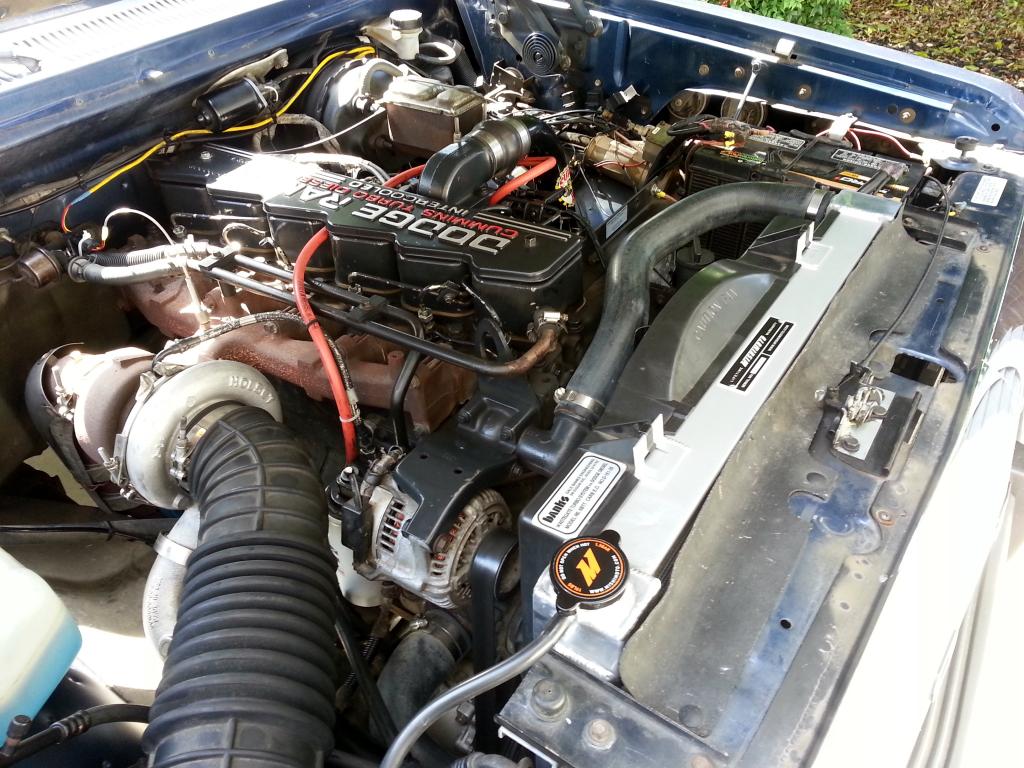

Just installed a Mishimoto unit in my '93. It is a bit cheaper from a vendor of your choice (versus buying direct) but are about double the cost of the Spectra unit. Whatever your experience with Spectra, I think a high quality, more durable unit with increased cooling capacity is worth the investment. Easy bolt-in part, works flawlessly, and really improves the looks of the engine bay.

Yeah, that is the correct number. You're looking at about $600 from an a vendor. Interestingly my temp seems more stable now, warms up seemingly more quickly and then stays put even under load, A/C on, and warm ambient.
