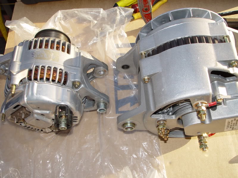

I'm looking for a new alternator, and I'd love to do the 160 L/N alternator that JIm Lane did in the Sticky, but I may need to do it quick. I have looked around at HO alternators that are drop in replacements, and I know there are some quality products out there, such as Iraggi Hand-Built Alternators. These beautifully crafted, hand-made beasts can be had in 220A models that are drop in replacements for OEM. I have seen these alternators power competition stereo vehicles running over 30,000 watts RMS with enough 0-gauge power wire to reach Venus. I'd love to have one...only problem is, they're super expensive and their applications for older trucks is limited.
I am looking around at other options for HO drop-in alternators and a company that keeps coming up is Eagle Auto Electric in Northridge, CA. They seem like a no-bull company that has a great reputation. They make drop-in 200A alternators for our trucks that are pretty reasonably priced (just under double what a cheap reman would run). Looks like a nice piece.

Before you go and replace your stock 120-amp NipponDenso alternator for low output, try this and update your charging system wiring, believe it or not the factory wiring is trying to push 120-amps through a 6-gauge wire so a good amount of your current is being wasted as heat, do this long enough and you will have melted wiring and melted connectors.
Before I replaced N-D with my Leece Neville I replaced my charge wire using a length of #2 welding cable from the alternator (+) post to the battery positive terminal and also you need the have the same size ground cable from the alternator to the battery for it to be effective.
I have installed quite a few modified alternators on both my own vehicles and for customers and the one thing that I have found out is most of the rebuilds will only produce high current for short periods of time until they burn out and I have found the regulation was not good.
I have worked for years as a diesel mechanic and electrician and have changed and rebuilt many many BIG Leece Neville and Delco generators and alternators.
The byproduct of high current is a whole lot of heat that has to go somewhere and there is not enough mass in the small frame alternator to dissipate much more that stock
If you have a need for a lot of current the Leece Neville is a fairly easy project, the 110—555JHO alternator will produce 100-amps at idle and 160-amps cruising continuously.
Which one do you think could dissipate the heat from 160-amps?
You also have to upgrade the rest of your charging system as this would burn the stock wiring almost immediately.
