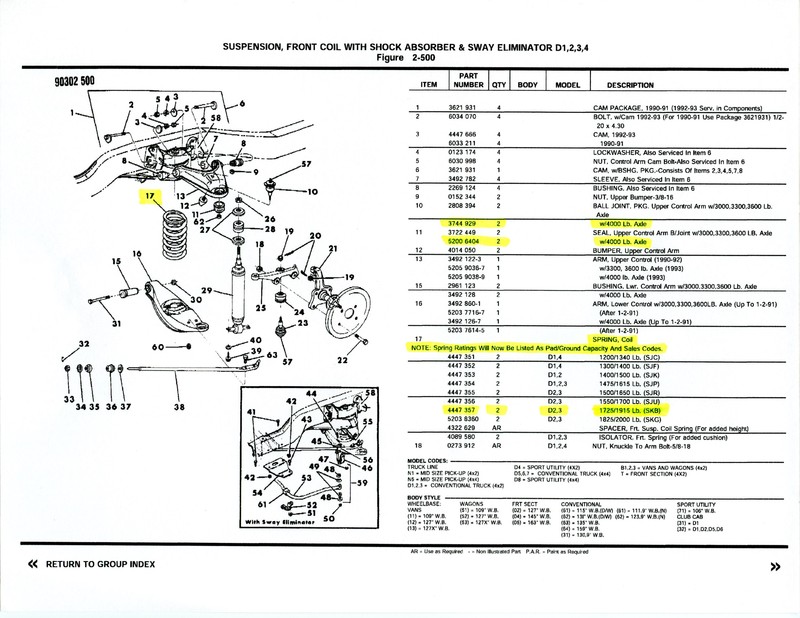

Now here is where I need the help, I checked with my local Dodge dealer for the springs and of course they have been out of stock for about 8 years now but he did give a lot of information.
According to my VIN number, my truck has the "SKB" spring code.
SKB code =1725/1915 lb "SKB"
SKG code =1825/2000 lb "SKG" I DO NOT have.
What it Pad/Ground capacity and how does it relate to Spring Rate? (see description for OEM springs)

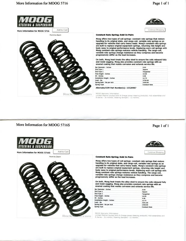

Now looking at the MOOG application for my truck,
#5716 is 1429 lbs Heavy Duty Service
#5716S 1430 lbs Severe Duty
See my dilemma, which replacement spring is equivalent to my OEM heavy duty spring?

It is my understanding that the aftermarket aka Moog only offers two different styles of springs and that the "S" variants are their own devised contraption not based on any factory/OEM spec but rather based off of a chevy coil. (Also notice how the "S" model has no OEM PN cross reference)
My understanding is to go with the non-S. I installed and fully rebuilt McKnittle's old 2wd arms and chose to do so with the Daystar coil Spring Spacers with 7226 and it has turned out great and rides very smooth.
If you haven't already, this is an enlightening read from Mysteryman https://www.turbodieselregister.com/threads/240087-93-2WD-Any-way-to-raise-the-front-end-up
Here is a quick excerpt. BTW I'm not sure I understand the difference between the 7226 and 5716 Parts. Terry says use 7226 only.
"2) Coil springs. This is very important !!! DO NOT BELIEVE WHAT THE PARTS CATALOGS LIST . All of the aftermarket suspension manufactures catalogs have listings for "super heavy duty springs" Do NOT BUY THEM ! THEY WILL DESTROY YOUR FRONT END!!! GMC/Chevy coil springs have a near exact diameter a ours do. They will fit but the spring rate is way too high ! They will crush your upper control arm bushing out in a a few short months. They will also cause the control arms to bend ! All those heavy duty / super heavy duty springs they list are actually Chevy springs. The springs that came with our trucks rarely sag vary much. The problem is what I mentioned above. It is the problem 99% of the time. But If you feel that you just have to replace them. THE CORRECT AND ONLY PART # TO USE IS MOOG # 7226

I used the 5716 in my truck, it raised the front end about 2 inches. The truck sits level now. I have no complaints with them after more than 2 years with them. Although I bought many of the front end parts from Rock Auto I got the springs from Jegs. The only complaint I have is that I am not able to keep outer tie rod end boots on the truck. Seems they are ripped, torn or gone within a few weeks. Maybe this is due to the increased angle since the front end sits higher, I don't know.
I will say this though. I was not really impressed with the Moog parts. The top of the line NAPA parts are better quality but expensive.
