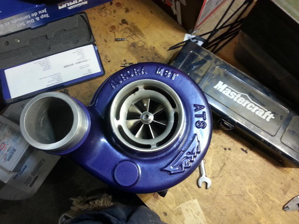

I must say, the aurora 4000 charger is NOT a reboxed mildly worked over charger. The compressor is the same dimensions as an s364 (inducer - 64.5mm, exducer - 91.44mm) but it's very clearly a billet wheel or something of the sort. It's not a BW cast wheel, and I think that's all the BW wheel ever was. The turbine wheel is something very strange too as I have never seen or heard of or read anywhere with a wheel that is listed with it's dimensions. It is exactly what the ATS site lists it as. 70/76.2. It's an odd size, that's for sure. The exhaust housing is the BW .85 twin scroll, non-wastegated housing cut for the turbine wheel that ATS uses. It should be a good housing. And I have high hopes for this charger. I hope spool isn't an issue. I don't think I will have enough fuel for the air this charger can push.
I don't even think the compressor housing is a BW product. It looks almost like an ATS casting as it's shape isn't quite right to be a BW. I won't be home for 2 weeks but when I do I'll post pictures and all that fun stuff. Maybe even before and after videos.

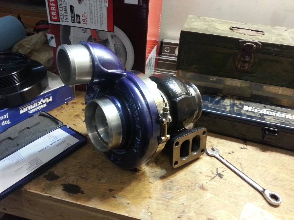

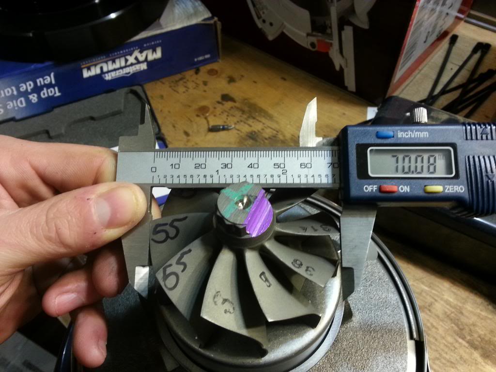

the turbo itself

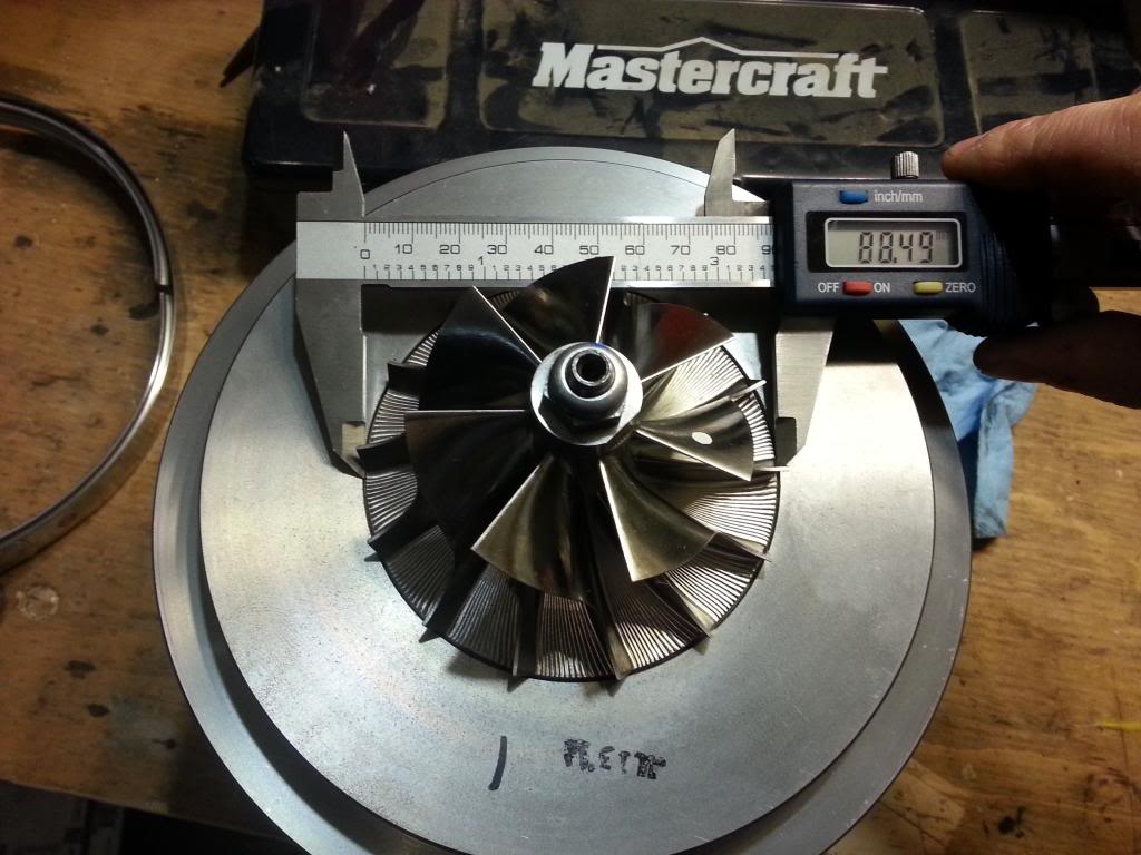

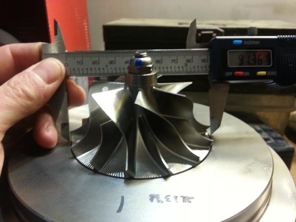

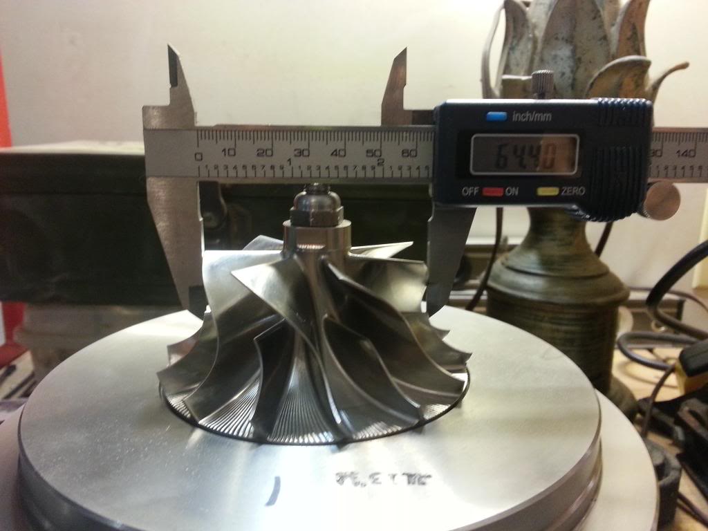

compressor inducer
exducer
or...

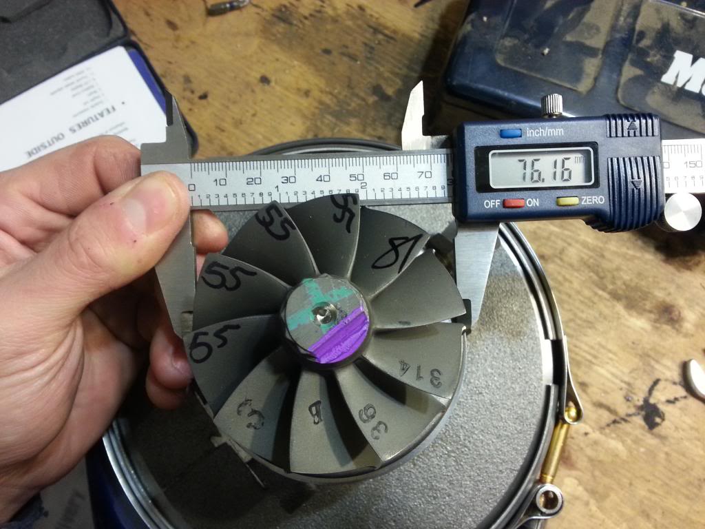

turbine inducer
turbine exducer
And that is all packaged inside a non-gated .85 t3 exhaust housing. 6 bolt outlet with a custom made hx40 flange.

I don't trust the calipers to be perfect, nor are my measuring methods. They are just cheap mastercraft ones and I'm no rocket scientist, but you get the idea. It appears to be a 64/70/.85 turbo. the compressor wheel looks like a billet wheel as you can tell by the machine marks on it. the exhaust wheel is some sort of custom creation too as BW doesn't make a wheel with those dimensions.

I'm not sure if they offer a t4 housing or not. I don't think so? I know they offer the .76 housing but it's a single scroll and I'm pretty sure a t3. They also offer the 1.0 housing but I don't know anything about it.
And the purple really doesn't look that bad in person. It's a quality paint. I guess for those that don't want it you can easily enough throw some rattle can over it.
