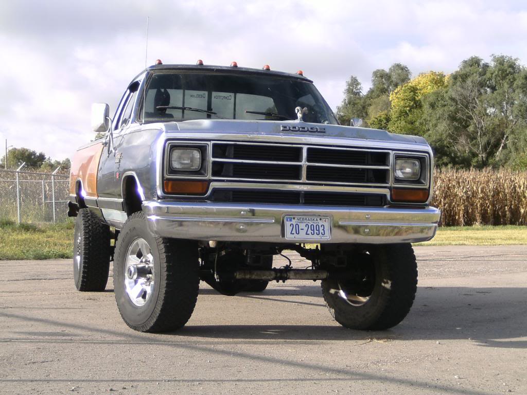

I put a used Rancho or Rough Country dual setup on mine off a 1/2 ton gasser. Its the dual setup that kicks each stabilizer shock out to each end of the tie rod not the stacked dual setup.
You can see my setup in this pic

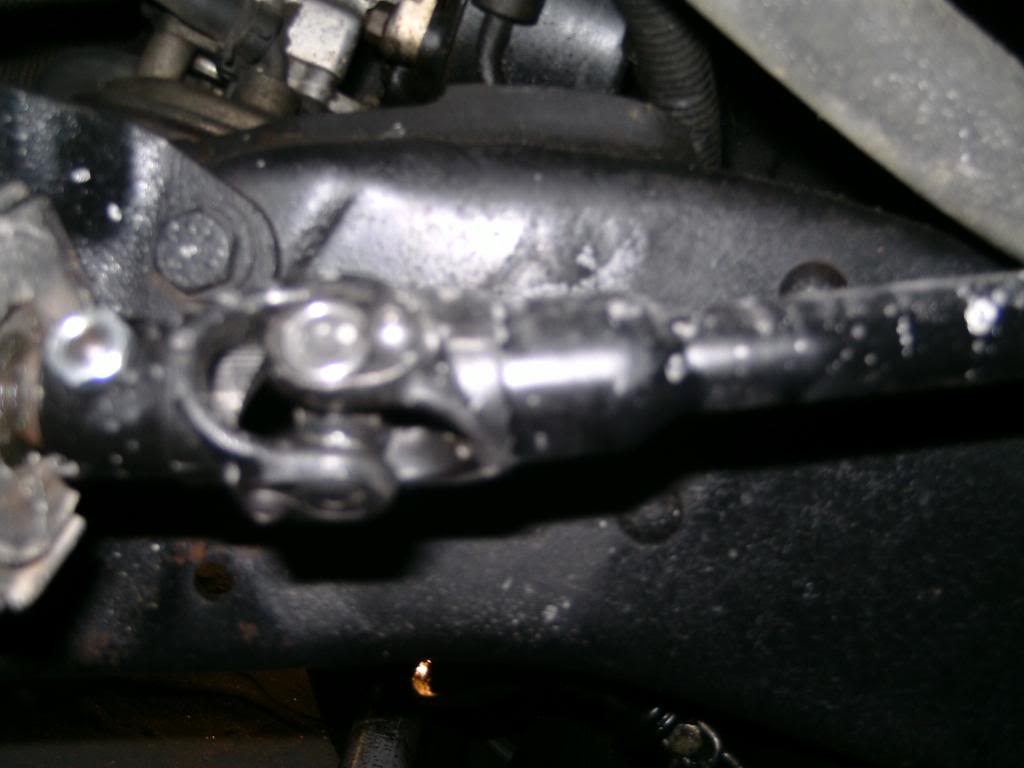

If I were you I would just make your own homebrew steering shaft and save some coin.
There is a thread in the sticky with good pics and some links to get the joint.
I have been debating on doing this. My buddy just got a borgeson shaft and box for his 92 and he acted not that impressed with it and lookin at the borgeson shaft, it didn't look that strong for the price but maybe that was just me. I could probably build one pretty easy. Thanks for the help.
