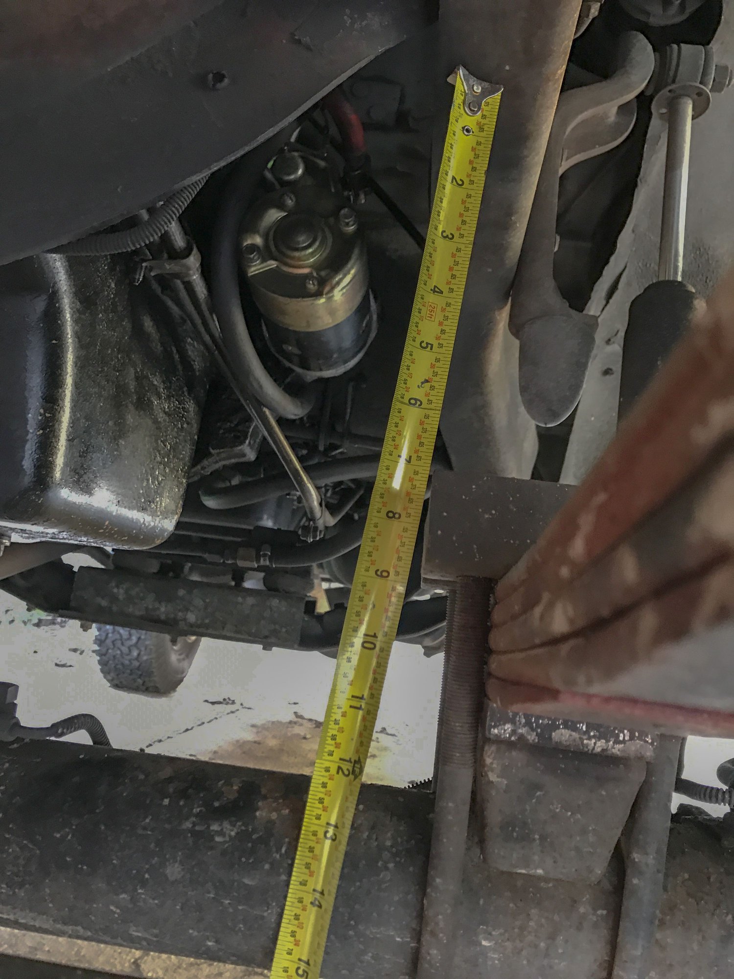

Thanks Gents! I found a side shot of my truck. Hopefully you can help me figure out the lift! Much appreciated.
Old 02-25-2017, 10:59 PM
RamGuy84's Avatar
Join Date: Sep 2014
Location: Ca.
Posts: 236
Received 19 Likes on 14 Posts
Look's to be roughly 3 inch lift ? How much room from top of spring to bottom of Engine cross member . That is Main area you need to watch for crossover Steering .Hand's Down crossover steering is the Cat's Meow .

I also have the rrsg set up on my truck. Best mod ever for me. Did a write up on it, and its in the sticky
https://www.dieseltruckresource.com/...y-92-a-301769/
My springs were 3" re-arched plus 2 extra leafs including a thicker main spring. You have 1" higher than mine, so you have a 4" lift
They naturally flatten out over time about 1/2" or so, so 3.5" lift to be safe.

Took a new pic, hopefully this will verify. Sounds like a 4 inch? I'll check out your write up! Thank you big time for the help!
"NJTman;3321998]I also have the rrsg set up on my truck. Best mod ever for me. Did a write up on it, and its in the sticky My springs were 3" re-arched plus 2 extra leafs including a thicker main spring. You have 1" higher than mine, so you have a 4" liftThey naturally flatten out over time about 1/2" or so, so 3.5" lift to be safe"

Thanks Ram! I posted a better pic of the measurement. Thanks for the help Bro!
