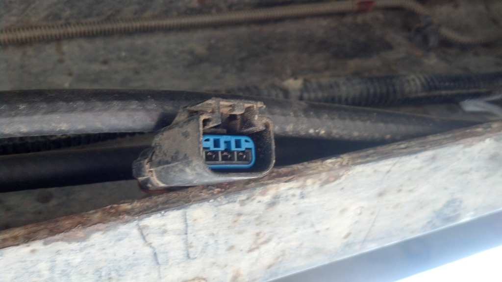

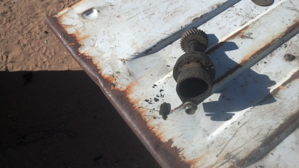

This is what you need

Size:  113.9 KB is this the same plug off of the trans as what you have ?

Ill have to get back to you tom. I hope you are talking about the 2 pic. The first pic looks like it came from tailshaft instead of side of tranny.

that is from a 2 wheel drive 518 auto from behind my cummin's the wire end is the 2 wheel drive wiring I am useing
