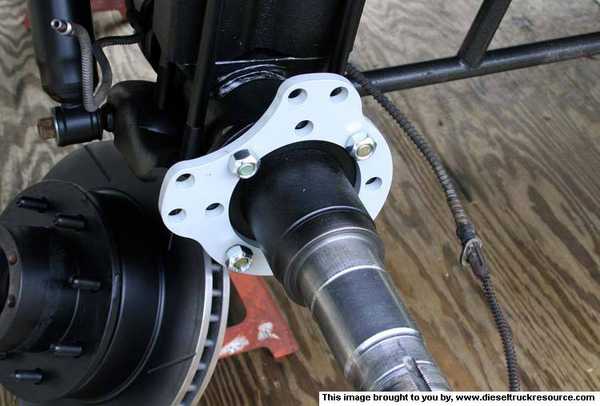

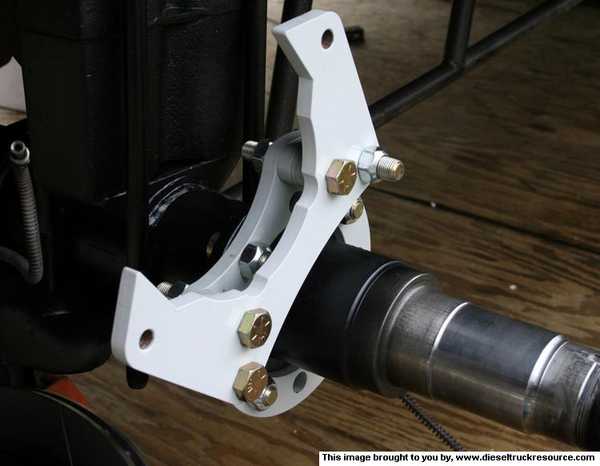

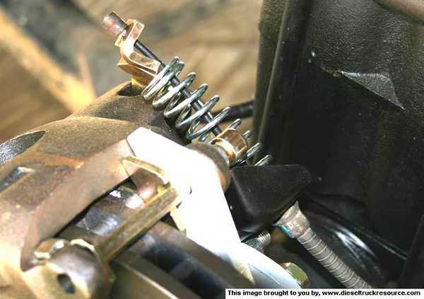

Ultimately I had to find a bracket that would mount to the caliper, and with a little modification, have it fit the PB cable sheath of the Dodge truck . . . .

Shouldn't the bleeder be positioned on top of the caliper at the highest point? I thought that was the only way you could get all the air out.

The more traditional mounting would have you swap sides with the calipers, and reposition the brackets such that the calipers would be just forward of straight down. The bleed ports would then be straight up and the PB cables would look forward as they should.

The goal was to install the calipers so that they'd be up and out of harms way, if you will. I had to remove the calipers and hold upright to bleed them. Takes five minutes longer.
