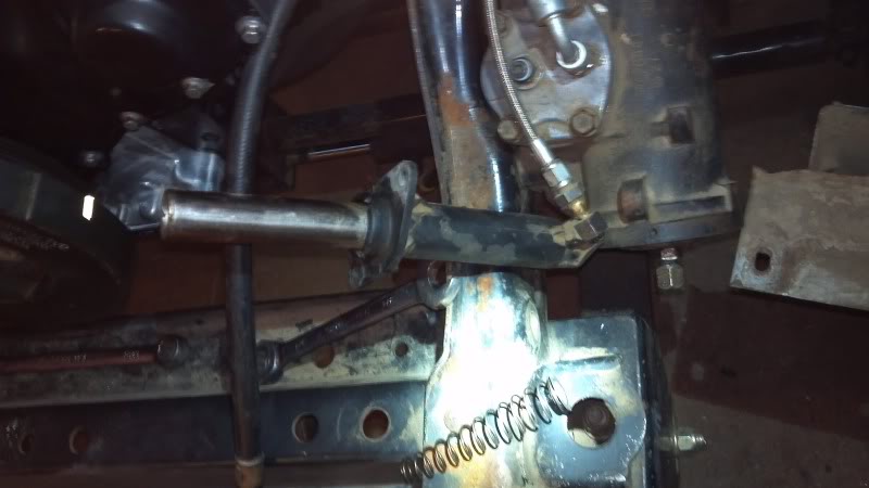

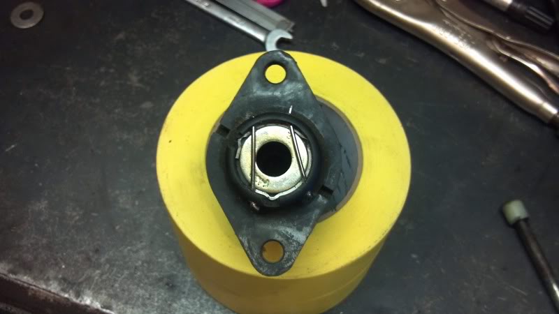

We got the clutch in the puller today and it disengaged nice once. Then oil came pouring out of the bellhousing and no more dis-engagement.
The slave fell apart upon removal. It looks like there was a steel inner sleeve that came out.
Anybody ever had this happen? Is it just toast?

By the looks of it, yes, the slave is toast.
I assume you maybe didn't compare the total clutch heights between the stock and aftermarket clutch?
There's 3 notches to hold a round wire clip that retains the plunger assembly.
In the 2nd pic it looks like at least 2 of those 3 notches got ripped out.
That tells me that the piston assembly over-extended and you pushed the guts out, OR the hydros weren't installed correctly and something slipped causing failure.
Over-extension is probably the culprit here, especially since your using aftermarket clutch pieces, which may have a shorter cumulative height than the stockers, causing the slave to push further down the bore.
The fix for that is to make a longer slave pushrod and re-use your plastic pushrod cap.
Another thing that COULD have happened to cause the over-extension, is that the plastic pushrod cap broke on application and the pushrod slid that much further.
Mark.

Good eye Mark. After I looked it over sat. morning I saw the broken tabs and found the circular clip on the floor. I really don't think it is a clutch issue, it is all 2nd gen now. Except the slave and rod. Wich I was thinking was the same.
I am thinking the petal must have got pushed down accidentally.
I have a plan to fix it. I will wait to see if it works and report back.

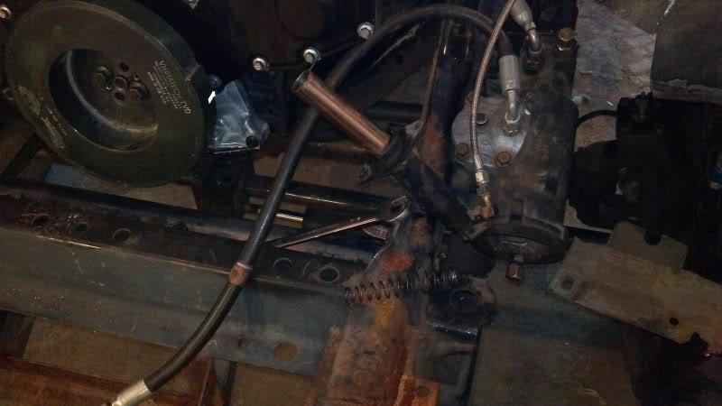

Fixed!!
Well with some old fashioned rigging we got it fixed. Put the clip back in, and a 1/2" hard flat washer just just happens to snap down inside it. Preventing the clip from compressing and coming out. Followed it up with 1/16" retaining pins, and its good to go.
Disengages just fine now.

Looks like it will work fine, but if you really needed one, all you had to do was ask.
