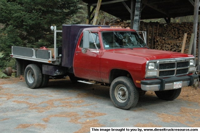

Hi,
I love my truck now. A while back I modifyed my truck. I wanted to do more but I ran out of time and money. So I have broken my mods up in phases.
So phase one is done and I have put over 1000 miles on it now. I remember that I posted about what I wanted to do to my truck and I got one response that said "that sounds like a project where the truck will end up on cinderblocks in the front yard". Or something like that. The funny thing was about 1/2 way thru the project I remembered that post and I was not going to let that guy be right. But it was close.
Here is what I did.
I rebuilt and regeared a 88 Ford F450 rear end.
I welded that Ford frame section on.
I extended the wheelbase a little.
I had to have a 2 piece driveshaft made.
I had to modify some Porsche calipers for my parking brake system.
I welded up a box for a sleeper so my dogs could ride in comfort. Down to one dog.
I got some Caddy seats and installed them.
I installed Ford hydro brake booster.
I had to widen my Alu. flatbed.
I still have a bunch of work to do.
I need to fix the cowl cracks and one rocker and one hole in the fender.
I need to paint my truck also.
I need to modify and install the Superduty front hubs and brakes.
I also need to finish my dump mechanisum. And finish my crane.
It was a ton of work but it was worth it to me. As now I love my truck.

Just curious,why the Ford frame section?
Old Oct 22, 2006 | 09:15 PM
DeanM's Avatar
Joined: Aug 2004
Posts: 201
From: MA USA
I wanted a dual rear wheel axle and the local truck junk yard had a F450 truck they where parting out so I bought the rear frame with the axle. I also bought the front axle for the hubs and 6 wheels.
Now to figure out how to post pics.
Dean
