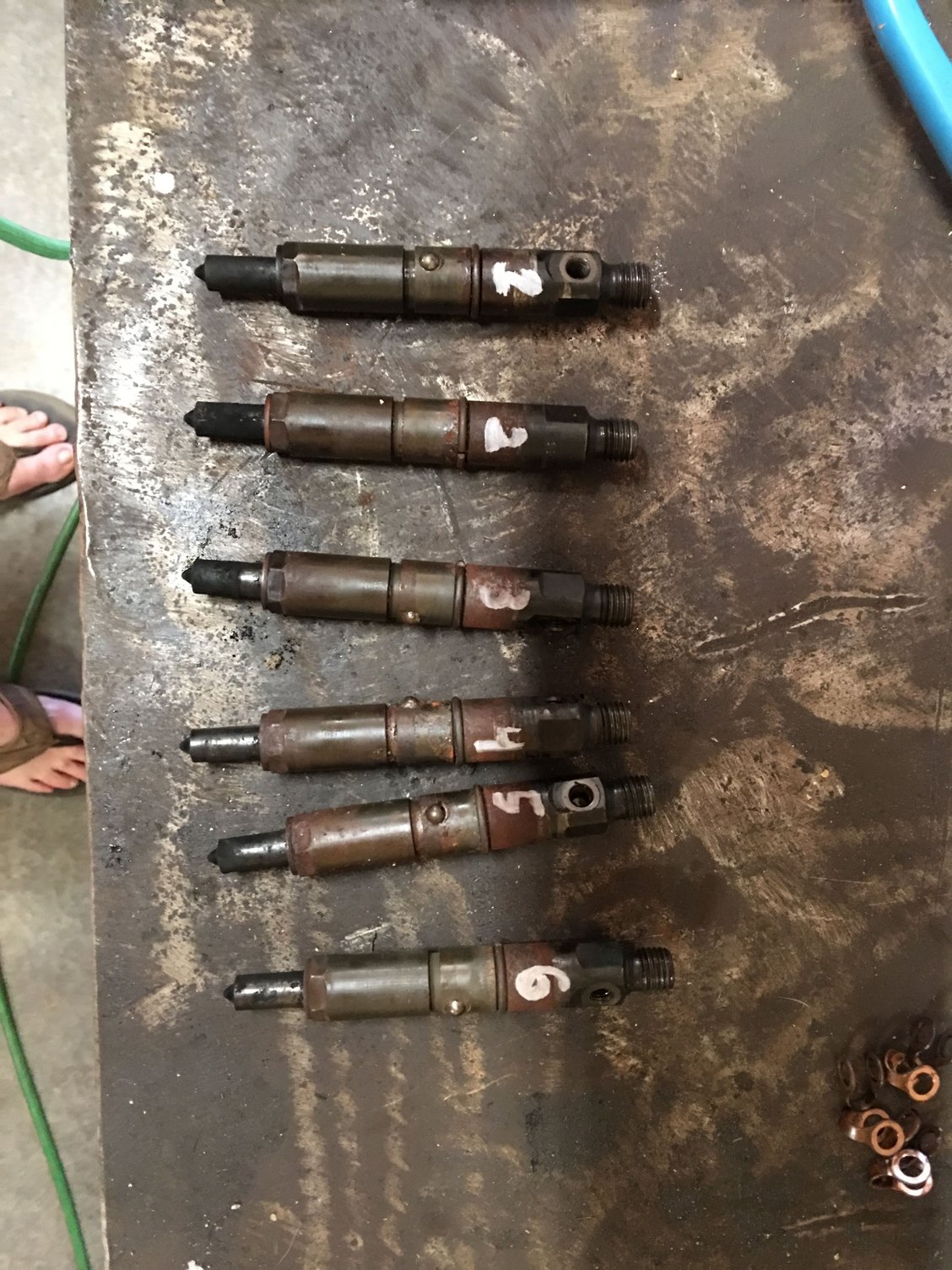

Got them out. On the way to city diesel in Knoxville now. The number one was wet all the way up. The rest were dry as a bone. They came out very easy. Someone must have been in them before I bought the truck. NOW....IF a man wanted a little bigger injectors what would he buy. Right now I'm planing on just getting stock ones.
