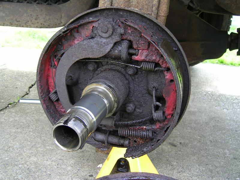

I recently re/re'd the rear axle in my donor 93. Got all new hardware, E-brake adjustment cables, 1.125" wheel cylinders, and brake shoes...all for about $100.
You have to re-use the most of the E-brake hardware though. But it is all good metal pieces and they clean up fine.
Here are my before and after pics....
