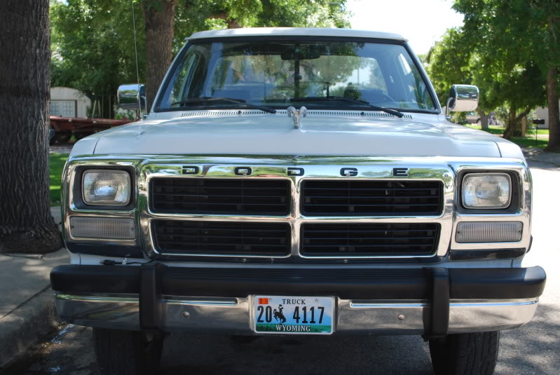

Instead of measurements, I just made a template of the base out of cardboard with the holes in it, lined it up where it looked right, then traced it out with pencil. It worked well for me.

38 3/8" with the tape hooked over the back of the hood to the back of the mount. 5 1/8" with a cloth tape from the front lip of the hood to the front of the mount.
There's been a pile of em on Ebay lately. Been meaning to get a new one myself since mine's broke off.
