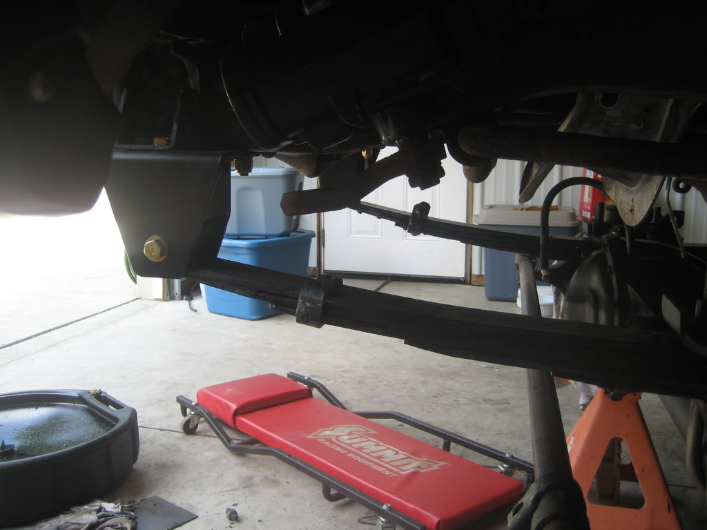

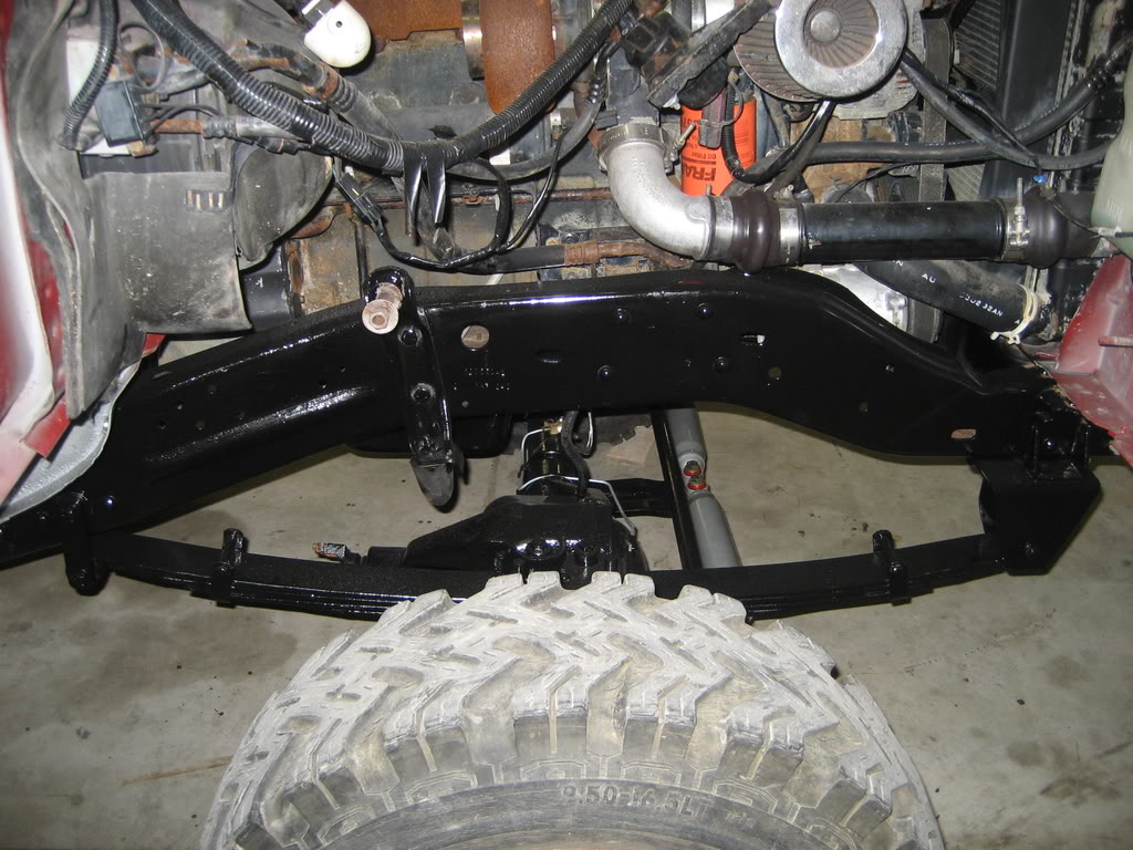

this is what ya need!!
I made the front drop hangers while retaining the factory length rear ones, reason being is, the sky 2.5 fronts don't come with a shim to set proper angle, So I made the front drop hangers about 2" lower than factory which ponted the pig up where it needed to be and it gave me an extra 1" lift. But, yes, by lengthening the rear swing shackle is the wrong thing to do to gain lift.
