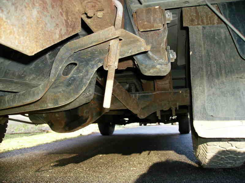

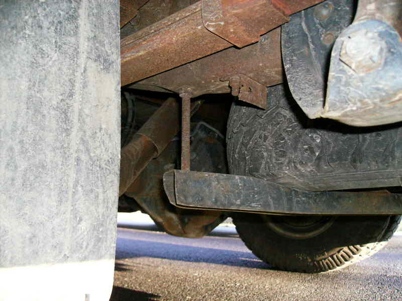

Ok, so my truck came with the spare tire in the bed, and I never got around to putting it up there. I got the long arm w/ piviot bolt from the PO, but I cannot for the life of me see how it would line up. None of the bolt holes line up in an obvious manner.
I have gathered from searching old posts that:
1. I am missing some sort of upper bracket (?)
2. The stock spare tire holder sucks.
I know its a long shot but was wondering if anyone had any pics of how this system is supposed to work.

There's a "J" shaped bolt that hooks in the frame, a wing nut on the "J" bolt supports the bracket. I'll go crawl under the truck and get a pic.
Attached Thumbnails Pic Help - Spare Tire Carrier-spare-left.jpg   Pic Help - Spare Tire Carrier-spare-right.jpg

Looks like the part I am missing is the J bolt. Makes sense now, I had it layed out exactly like yours is + I was wondering why the bracket mount hole extended several inches past the frame. I was beginning to think I had the wrong bracket
