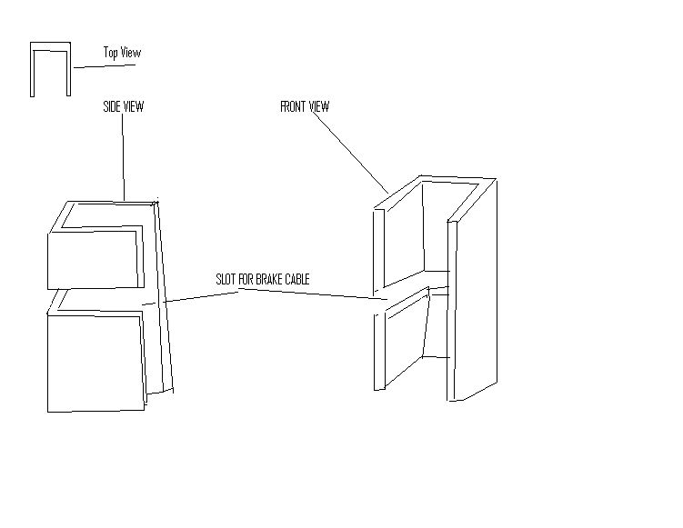

The round kind can be made from the correct size brass cartridge-casing.
Some cables come with a flat three-sided keeper threaded over the cable, before that lead slug gets crimped on, so it can't get away.
The long coil-spring keeps it pushed against the lever, locking it in place.
A longer piece of thin flat metal can be slotted in such way as to be open on one side, after it is folded around the lever via two 90* bends, with the cable being in the slot and the spring keeping it in place.
I could make one in ten minutes; the trouble is in getting the idea typed in a way that you can envision it.
Old Nov 9, 2007 | 01:16 AM
Chrisreyn's Avatar
Joined: Jun 2004
Posts: 2,156
From: Lyndon KS
BearKiller, is this kinda what you mean?
look ateh drawing and see if this is what you are describing...
Old Nov 9, 2007 | 08:36 AM
BearKiller's Avatar
Posts: 6,457
Likes: 95
From: KENTUCKY
YES !! Exactly !!
Thank you.
