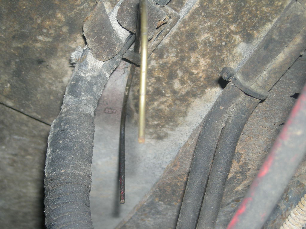

OK, dumb question, but what is the PTO cover bolt and where is it located (obviously high up on the case somewhere) . . . I kinda like pullin the shifter out idea by 6BTA . I had to replace the shifter once. The stick broke off it while I was driving, kinda panicky but also hilarious, better than the steering wheel. Shifting with a big vise grip worked to get me home . . .
As BearKiller said there is a lot of different ideas how to over fill it.
Mine is the basic simple idea.
https://www.dieseltruckresource.com/...3&ppuser=40988
This is the PTO cover and the pointer is pointing to the bolt that i used for the dip stick.
https://www.dieseltruckresource.com/...1&ppuser=40988
This is the dip stock that i made out of a old coat hanger and were i store it when not in use.
Ok them pic's above are real small and hard to see..........here is some better ones
pointer (icicle) shows the top PTO Cover bolt that was used
This is were i attach my dip stick when not in use
And this is what my coat hanger/Dip Stick look like
Flash
