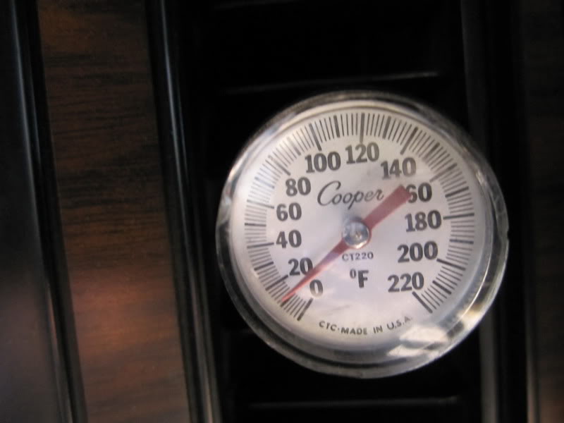

I grew up in the 50's and 60's when air conditioning was an expensive luxury you could only get in a few makes of vehicles, When I was young back in the 60's our family always traveled alot in a camper during the summer when my dad got his vacation, We installed an under dash Frigidaire AC on the 62 Chevy Apache-30 after making 1 trip across the US and into Canada, we bought our first air conditioned truck in 1970 a C-30 Chevy Longbed to pull the new self contained camper.
I can still remember how miserable it was trying to sleep with the heat and high humidity of the middle states and being chased by tornado's in the flat states.
We took quite a few trips across the US to the East Coast in the years to come.
In our family after Brakes, Air Conditioning is the most important item to work in a vehicle.
On a typical 100+* day you will see us wearing light jackets to keep warm in my truck, my wife and daughter keep jackets or towels over their feet and keep whining "It's too cold"
The warmest I have been in my truck was several years ago when we went to Las Vegas, we stopped off in Baker CA. at A&W to get a drink and the temperature was 118*, opening the door to get out of the truck was like sticking your head into a blast furnace, despite the superheated temperatures the temperature gauge was still on normal and my transmission fan was ON.
