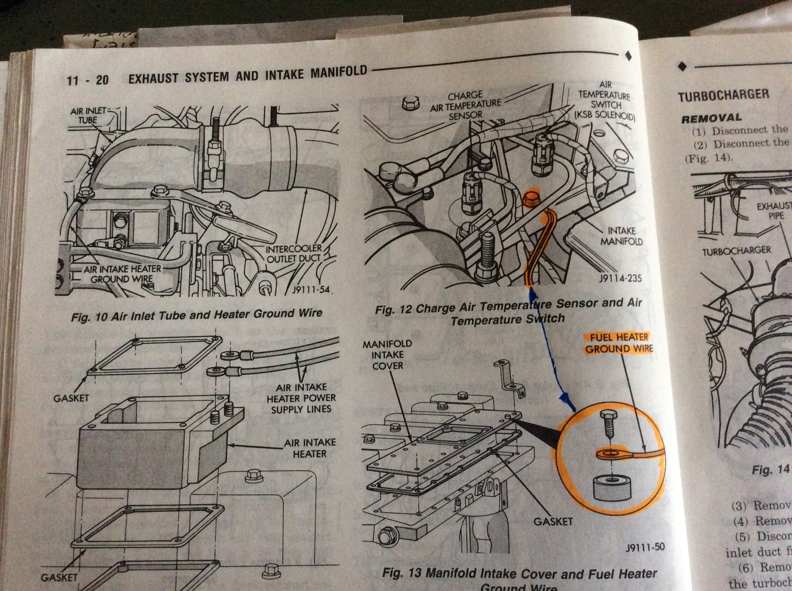

I'm in need of verification, on a two wire ground connection that mounts onto a bung on the intake manifold. It is the ground for our fuel heaters, and for other items. A couple months ago, in my hurried scamper to button my truck up before surgery, I feel maybe I missed reconnecting this ground. I've looked thru old photos of my intake plate, and have not seen that ground connection, but it states it clearly in my FSM, on page 11-20. I've called on MKnittle to verify, and on his 89, it clearly shows that connection on his plate. I'm wondering, probably from the previous owner and whoever he had work on his truck, maybe it got tucked up somewhere and that's why I've never had it in my old photos.
So, can you 1992, 1993 folks please do me a favor and just verify if you have this ground terminal on top of your intake plate?
The FSM mentions a malfunction of the fuel heater can cause/ lead to idle haze. I already know from others I've been PM'ing on my bad, bad haze issue I've got other, more complex issues to fix( thanks, guys. You know who you are), but if I can cross this ground wire issue off my list, so much the better.

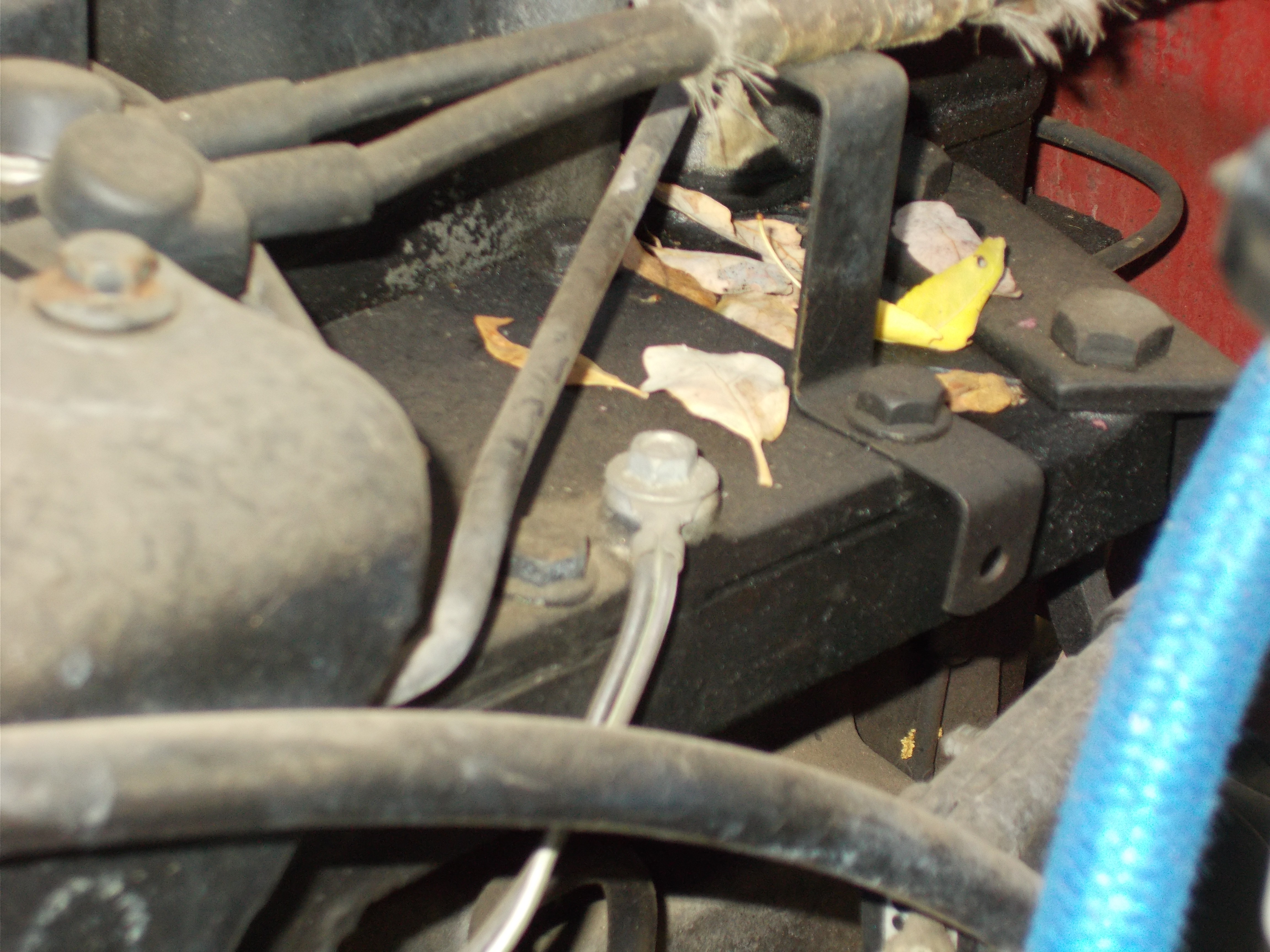

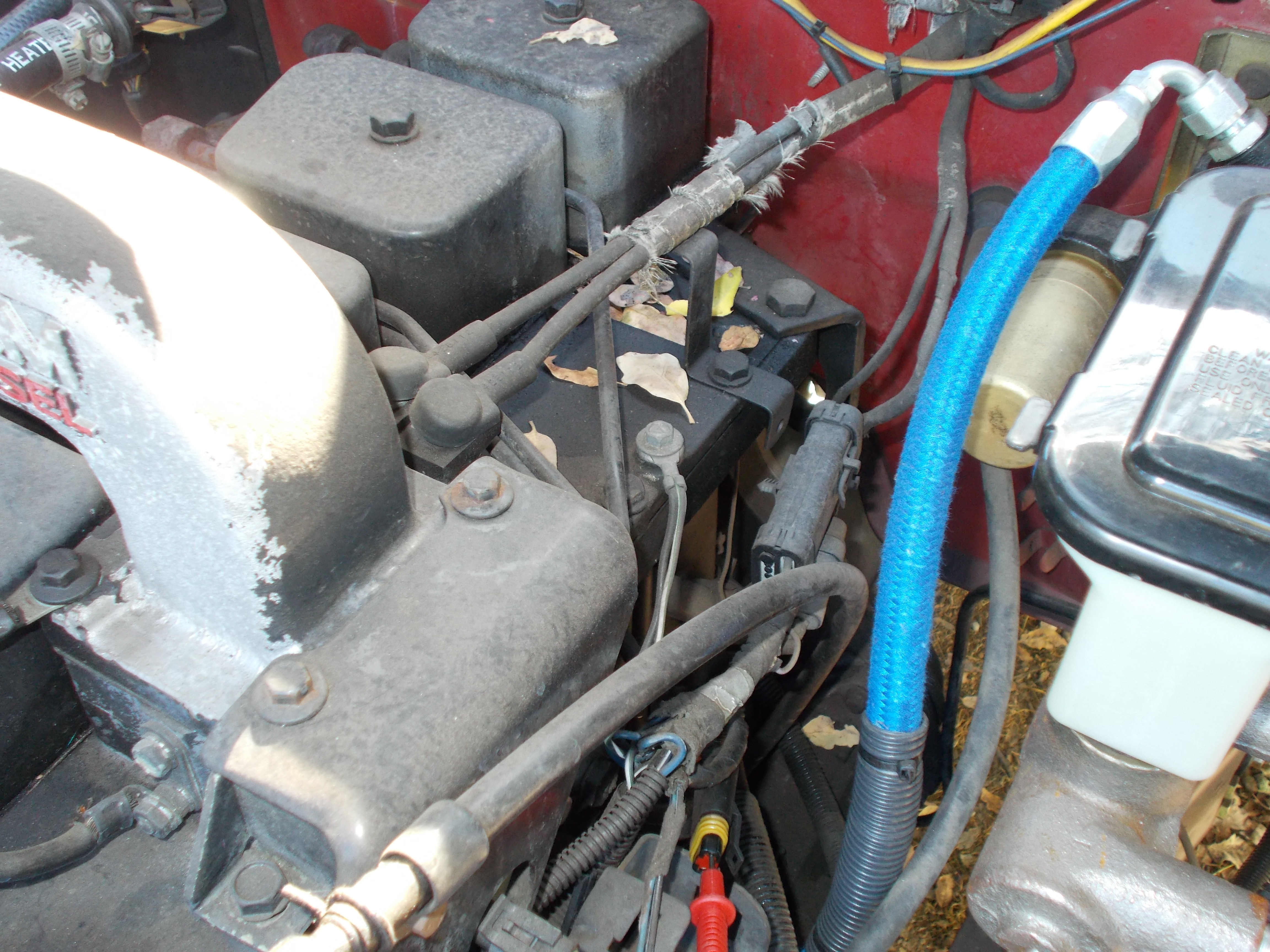

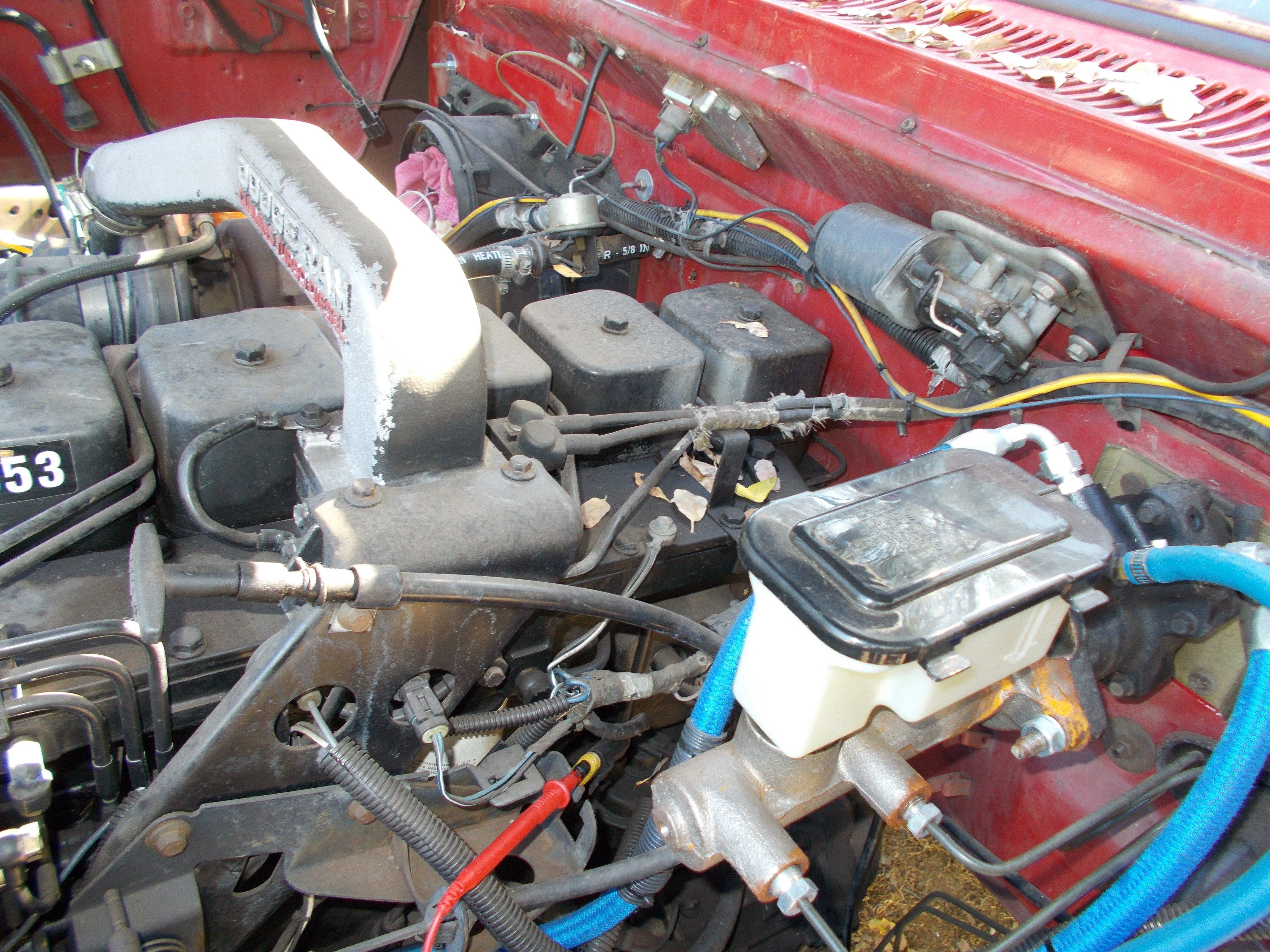

Doodlebee, thanks for taking the time to check and post a pic. I almost replied that yes, you have that ground attached, but upon zooming in for closer look see, it was the wire wrap clamp I see, that attaches to the plate just to support the harness in place. That's your harness that goes from the KSB air temp switch to your KSB solenoid. It is held in place by one of the manifold plate bolts. I guess you don't have one, either?
I'm Wondering, if in our year trucks, maybe that ground got mounted elsewhere, and when Dodge put our years FSM's together, they just grabbed a generic pic from the earlier first gens FSM's, cause it falls in place with my FSM photo and MKnittle's pics.

I have the terminal & bung on my 91.5, and my buddy a few miles away has it on his 92.
