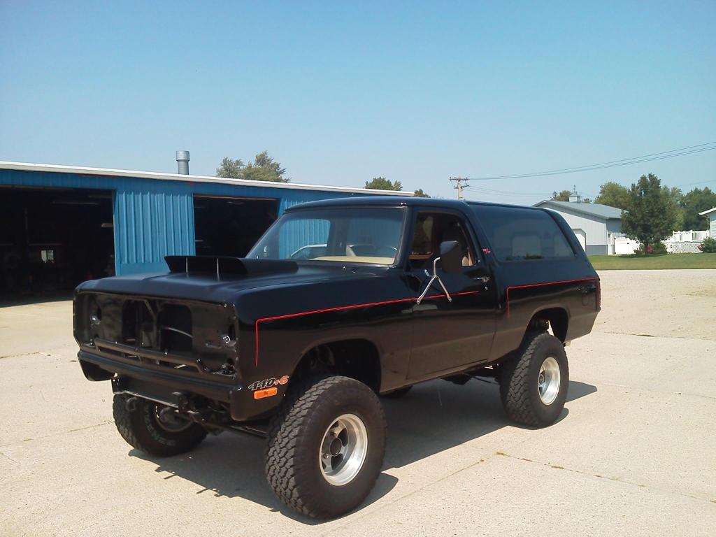

Heres the truck as of today. Hood is satin black. everything else is single stage PPG jet black.
Attached Thumbnails My Ramcharger R/T 440+6 build-bigpicture.jpg

I have almost the same scoop 440 6 pack that is going on my cummin's crew
for not being a Body n paint guy you did Awesome Work Man
