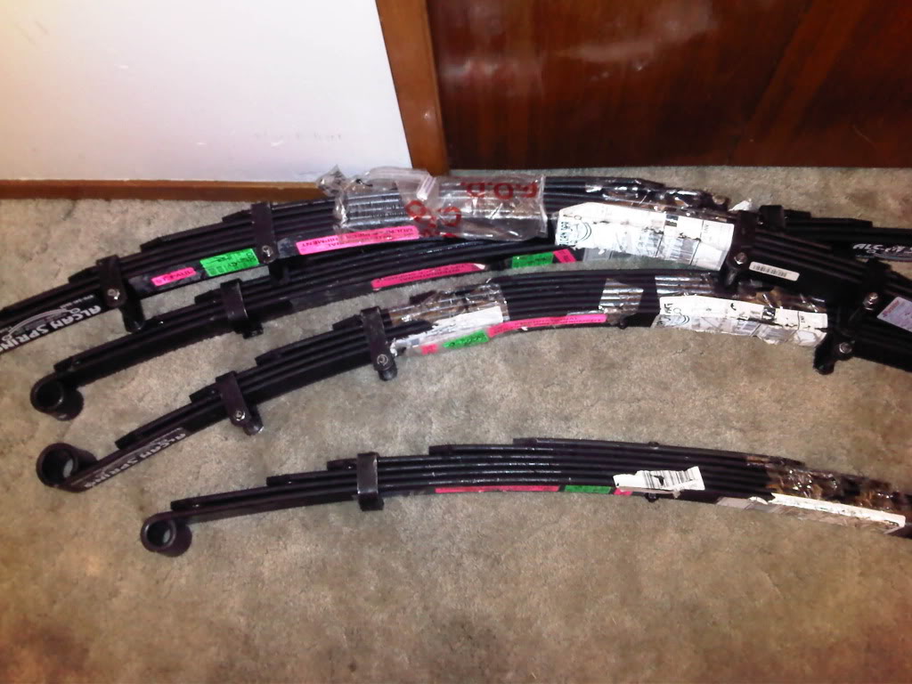

Springs are here! Pics tomorrow.

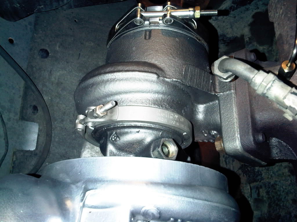

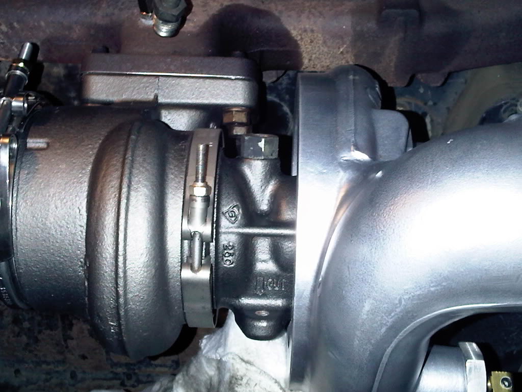

Anyone run a HE351CW in stock form, not clocked? The oil ports are on an angle and not sure if that will cause problems. I really had wanted to keep the wastegate functional but clocking does make the IC piping easier.

You are probably going to want to clock that. IIRC the max angle is like 15*. You can pull the little pins and rotate just the center to get good drainage. You could turn the housings, too. Just turn them equally and the WG should work fine. I have not personally put one of these on a 1st Gen, but I am seriously starting to want one.
Although, unless you have more than 375 hp worth of fueling, I'm not convinced of the need for this turbo to be wastegated on the 1st gens??? I drilled the wastegate out to 1 1/16" on mine, clocked it, re-welded the tab on the compressor housing, and installed a manual boost elbow. With the M2 pin, pump maxed, M&H spacer, etc, I'm only bumping 29 psi boost, so the wastegate (set at 35ish) never comes into play anyway.
