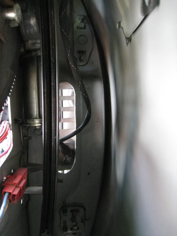

If you look up to the top right of the door shell you can see the bracket for the mirror, also the cable for the power mirror.

Another view of the harness.

Here are some pictures of the inside of our doors.

Thanks everybody for the responses and the pictures. I know taking off the inside panel is not that hard, but for some reason I just don't like doing them not only on the truck but on any vehicle.

Just a update. You have to remove the door panels to unplug the wire harness to the mirror. The plug connection is clipped to the door. I tied a strong string to the end of the wires to help feed it back through the door because it looked like a tight fit to get your arm in there. Thanks for the help everyone.
