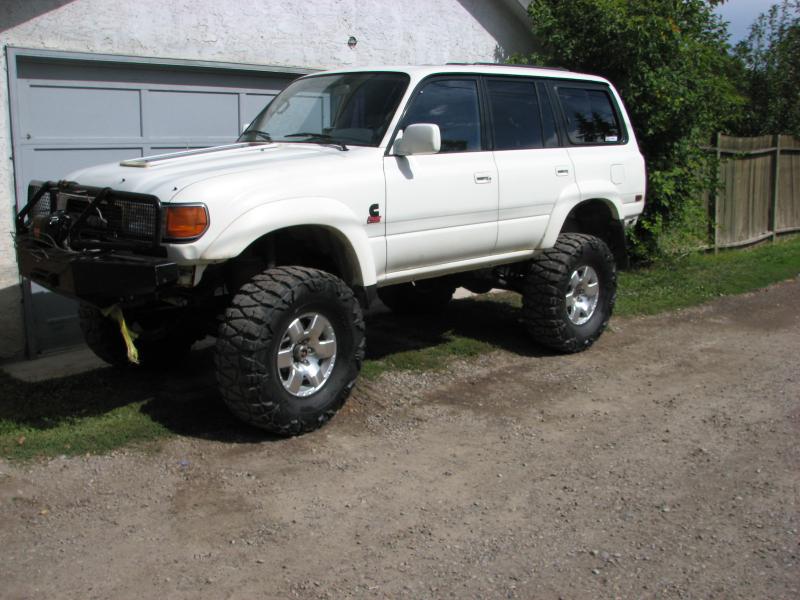

Well I installed the Denny T Version 2, advanced the timing a little and adjusted the screw for the fuel diaphram a little. The cruiser is a different beast now! It'll make a lot of smoke and go like stink if Im heavy on the skinny pedal, and the Pyro hasnt gone over the top with temps. That and I can break the 37's loose on pavement in 2nd now!
There's some pics of it here: http://forum.ih8mud.com/80-series-te...-re-build.html
Attached Thumbnails Minimum/optimum size IC for a non-IC'd 6BT-img_9253.jpg

Cool looking ride how well does it do offroad?
