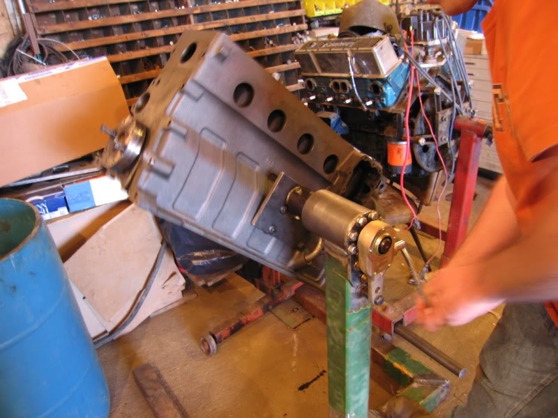

Well we ended up having to rebuild the puller motor. Just getting ready for re-assembly, will post pics when the time comes. For now, here is a heavy duty engine stand I built for it. Got tired of the using my old cheap stand, plus it didn't really like a fully assembled 5.9. I know the pics suck, but I'm having camera issues. It rotates on a 14 bolt wheel hub, turned by a slack adjuster off from a semi. I have seen this idea around a few places and have been waiting to get one put together. Use a 9/16" wrench to turn it where ever you want and it stays. I need to get wheels on it, but for now we can build the motor.

Where did you get the gear box?\
Edit,
I can't read, looks like in the video its does not take much effort to turn, is that correct?

The old s-cam trick, very nice job on that.

Yeah, it turns pretty easy, but it's just the block and crank on there now. A 3/8 cordless drill spins it just fine, just a little too fast.
You can get a new slack adjuster for like $20. The one I got is about a 22:1 ratio, the parts guy said there is only one ratio. I would go slower if I could.

Do you have bearings in that tube, or is the s cam just welded to an inner tube.

The outer tube is a wheel hub from a GM 14 bolt rearend. The inner tube is the spindle from the 14b, I used the wheel bearings and all. Slide the s-cam inside the spindle and weld.

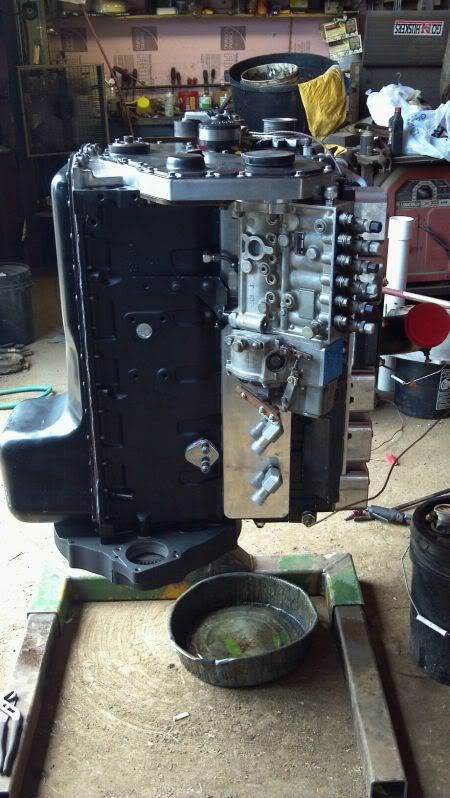

what is the mount point on the block?

Got around to getting some more pics.
The mounting plate, hooks where the motor mount would:

It ended up being pretty hard to turn when the engine was all put together. I am thinking my cheapy slack adjuster may be the culprit.

Your pump looks messed up.
