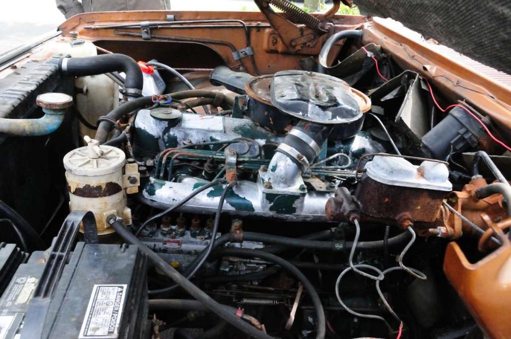

Funny Bob, every 1st gen i've ever driven with stock 12x2.5 brakes were good, like my Dad's D250 with the cheapest shoes from advance auto and cracked worn out drums, has the best brakes i've ever felt in a pickup truck. LOL.
I upgrade all mine to 3" W350 brakes, spend lots of $$. and i get crap. I also have a brand new raybestos "professional" grade master cylinder on my truck with a NON leaking cap.
I can't imagine the 1 1/8 bore wheel cylinders being too big to be filled as Dodge used them on the W350's with 3" shoes.......Or did they? Advance auto and Napa list 1" and 1 1/8" bore for a 91 W350 Diesel
My brakes are good on 2nd-3rd pump, 1st pump is all mush and feels like all front brakes doing the work, until 2nd pump i feel rear ones start to grab.
Maybe the 1 1/8 wheel cyl. is too much to fill on 1st pump.
Even more reason i need to put my Chevy hydroboost on with
1 1/4" bore master cylinder vs. stock dodge 1 1/8"
So what you gathered up is 1'' or 1 1/8'' bore and 12'' 2 1/2'' shoes is stock on these trucks?
Im looking for this hydroboost
