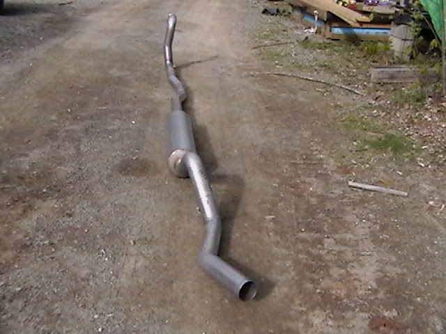

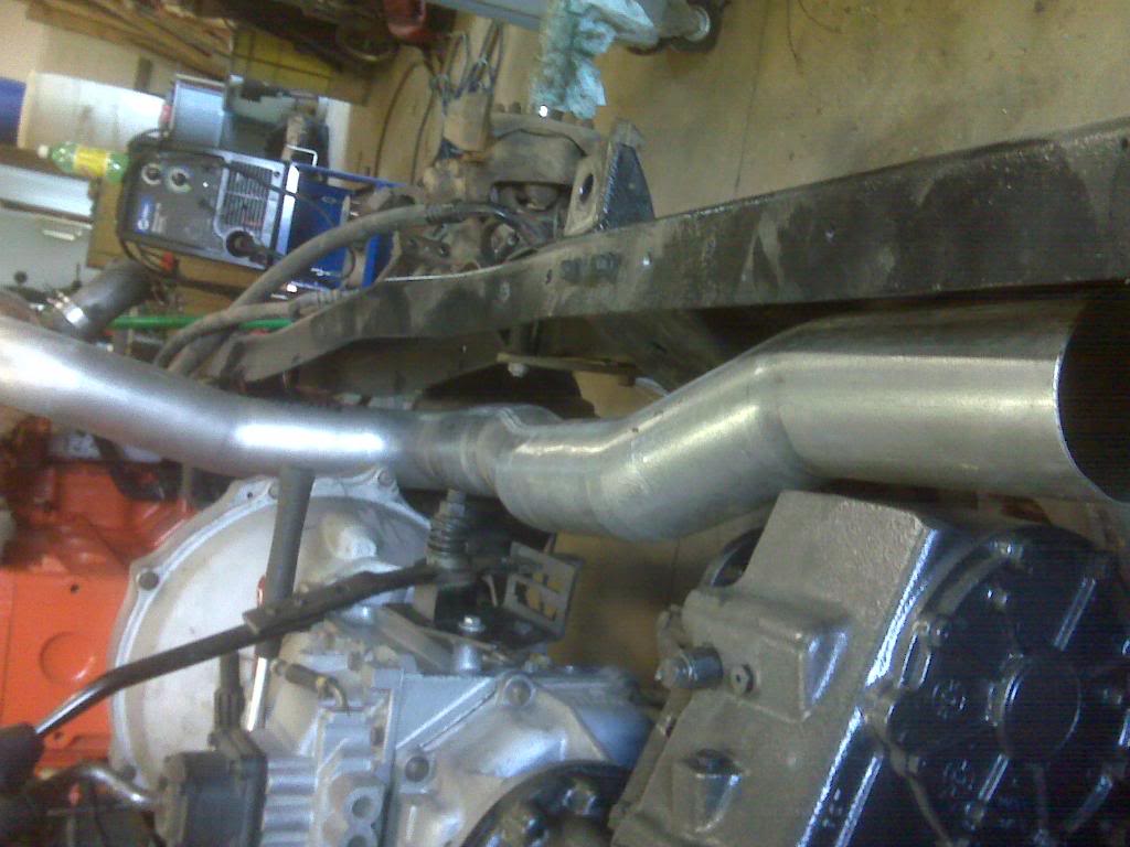

this is the part around the t-case, with my home made system
http://i289.photobucket.com/albums/l...s/DSCF4694.jpg

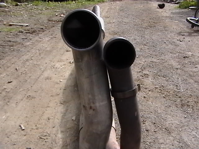

from the rear of the system looking toward the down pipe.
http://i289.photobucket.com/albums/l...s/DSCF4691.jpg

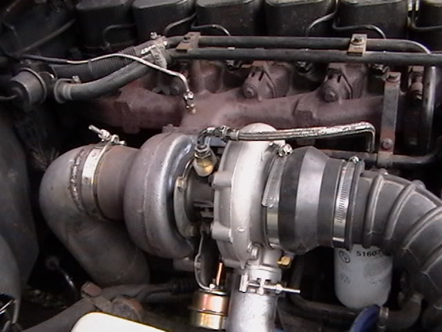

My stans kit with the HX40 flange to fit my S300.

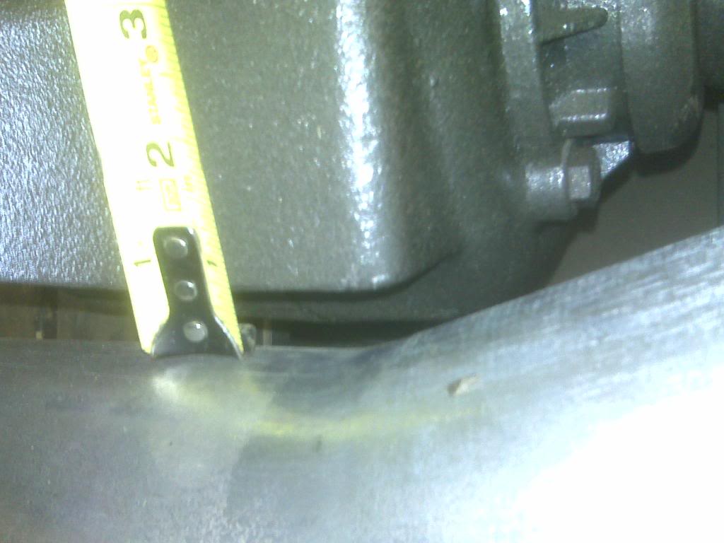

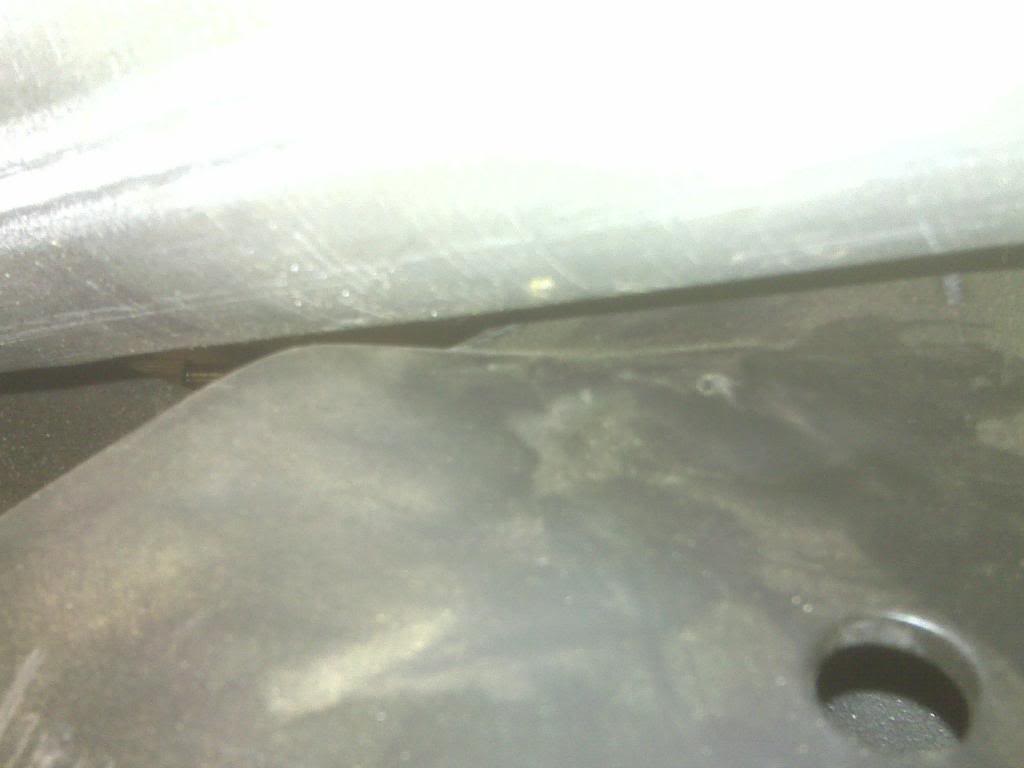

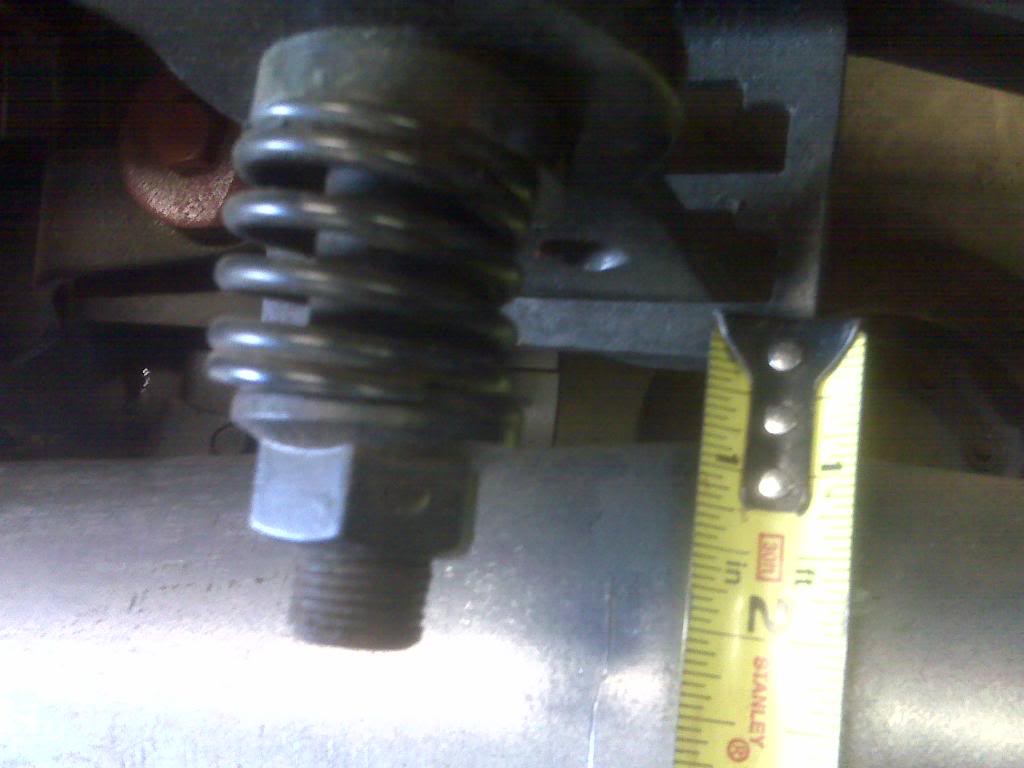

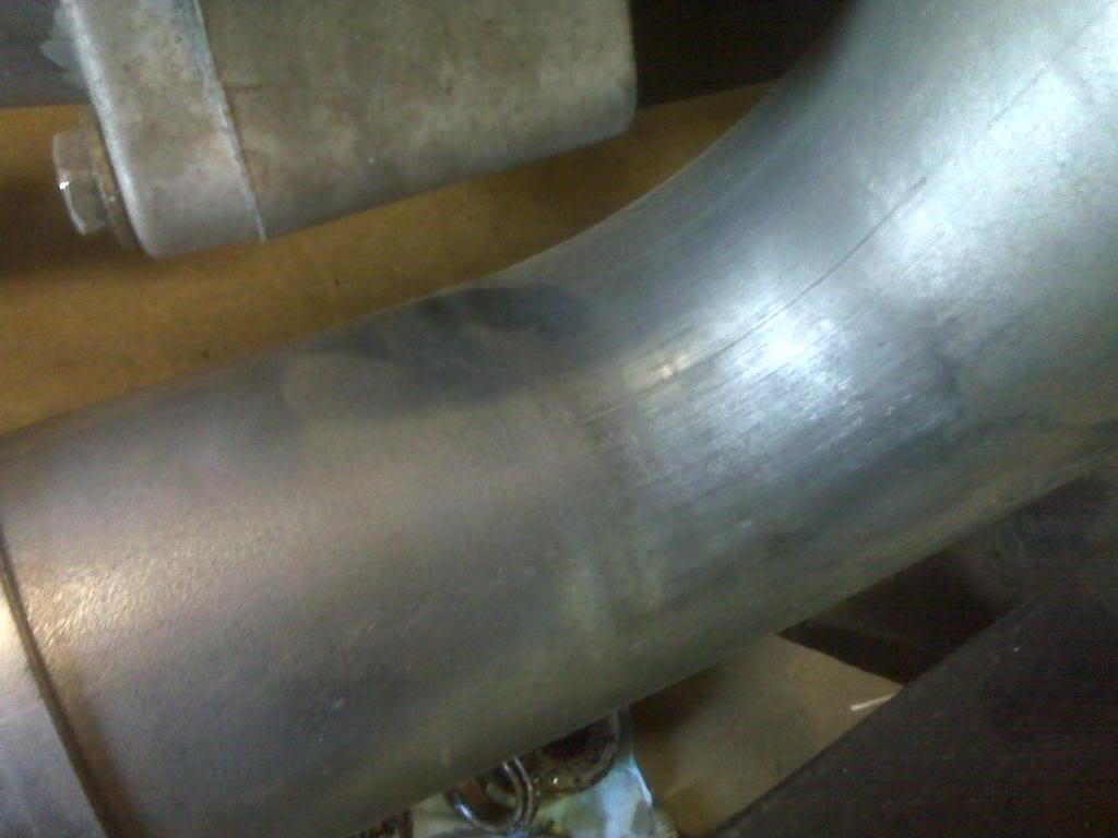

Here are a few pics of stan's laying in place.
Adapter plate clearance
T-case shifter clearance
T-case clearance
Front drive flange clearance
Crossmember clearance
