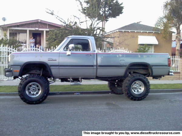

Pro comp doesnt make a lift for out trucks, only of the shelf lift for them are from Skyjacker. Forgot how to put pics in a thread look in at my pics to see a 8in(gasser)Skyjacker lift, tires in those pics are 37in boggers

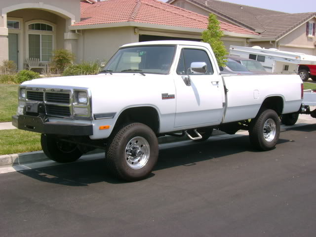

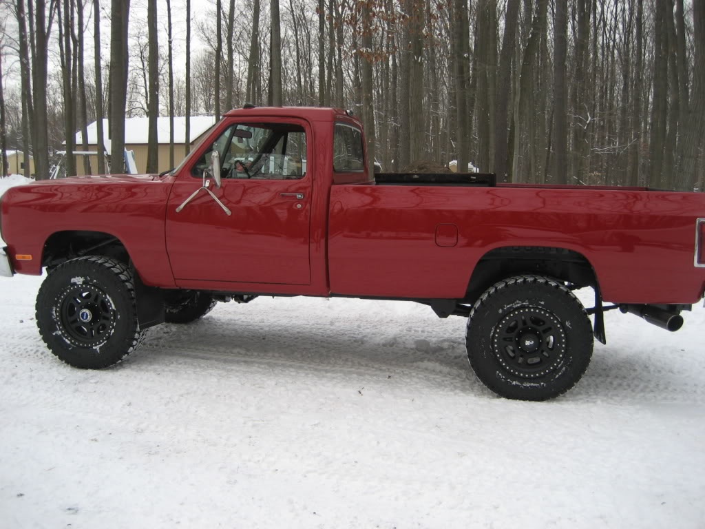

Here is a few of mine...
2.5 skyjacker springs in front with drop front hangers... about 3.5-4" total
stock springs in rear, Custom shackle flip, no blocks +2-3" over stock
Clears 35"x12.5x18 MT On pro comp wheels real nice
FYI... My reccomendations would be the 2.5 springs in the front with the 6" replacesprings in the rear with no blocks...
or
4" skyjacker springs in front with 6'' springs in rear with maybe a 2" block... Stay away from stacking any blocks on top of the factory 6" block..

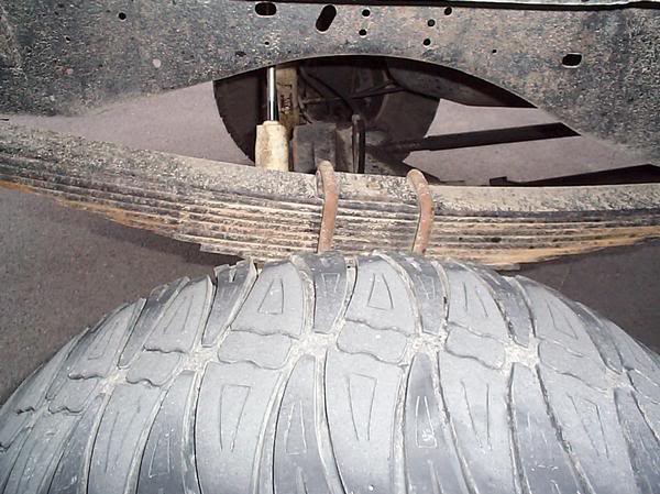

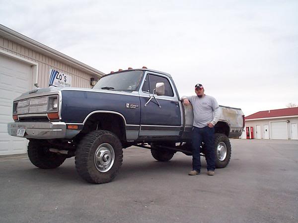

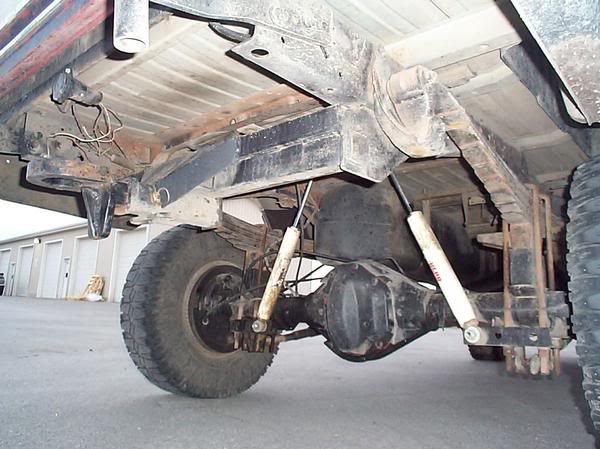

4" rancho gasser front leaves, 3" total on the front
Home built 10 leaf pack in the rear
Clears 33-12.50 Truxs STS's

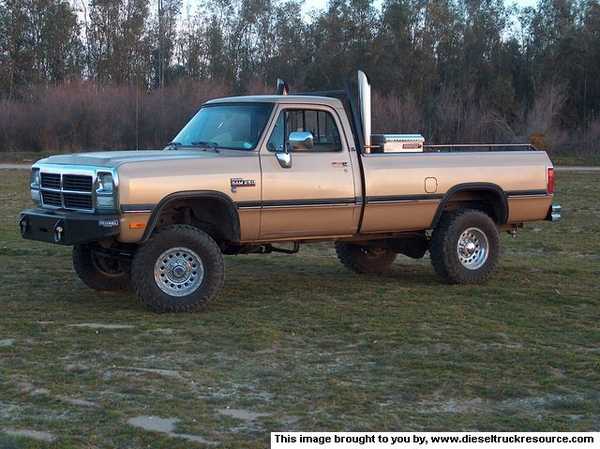

Not mine.

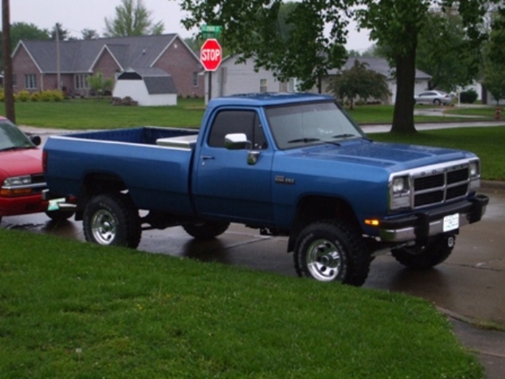

Here's mine, I know it's a 4 inch lift on 305/75R16 MTZ's. Not sure of the brand though, it was lifted when i got it.lift pics lets see them-dodge.jpg
