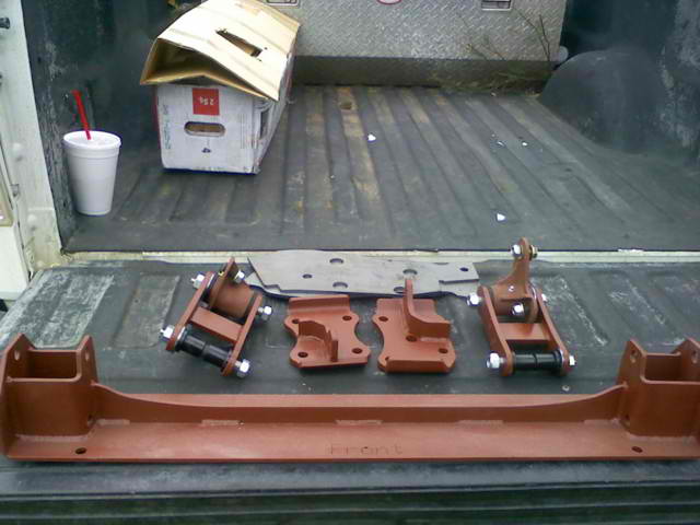

only on the D250 that has coils in front. The W250 has leaf springs.
There is a guy that makes a complete front spring hanger replacement crossmember and shackles. Nice parts. He goes by the name Jungle and he hangs out here.
http://ramchargercentral.com/jungleshddodgecomponents/
