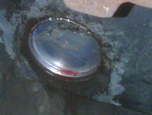

So I drove that new one in there as far as I could. This was rather difficult, as the exhaust is in the way of getting any real force to bear on it. Used a socket, and eventually, a long, thick round metal bar.
Put that bead of Permatex Threadlocker 27100 on there, as the OEM is unavailable. The instructions on the back of this say "Permatex Threadlockers fixture in approximately 20 minutes and are fully cured within 24 hours."
Does this mean wait 24 hours before adding coolant and starting motor ? The Cummins service manual PDF I dug up says nothing about that.
Also. The top lip of the new freeze plug cup pokes up slightly (1mm) above the surface of the block, while the bottom is in fully.
I banged and banged on this thing, it wont go in any further. In fact, by these pictures, you can see I resorted to banging on the top of the cup with my long metal bar, but this only dented it in spots.
Guess I find out if it's any good when I fire it up, right ? I have two more to practice with, but I don't see the result being any different whatsoever...

Frost plug looks good to me - I would not mess with it any more.
Leave the thread locker for as long as possible - if 20 minutes is all you have then it will still work.

Nope, the freeze plug I installed is no good. Let sit overnight with the red thread sealant, and coolant just weeps out around the plug instantly when I fill it up and start it.
I think...if I didn't deform the plug in the process of putting it in...that perhaps the hole itself is out of round from someone prying on a stuck plug sometime in the past, and no matter what metal plug anyone pounds in there, it will eventually leak. The stains on the block from old leaks below this plug attest to that theory.

By the picture and your description of how the new replacement sits uneven I would guess it leaks for that reason. It also does not help when you tap on it and dent it. I have been there too when you do what you need to to get it in. I bought a rebuilt 0 mile 350 chevy once and they pounded the cam plug ( same as a frost plug ) in crooked and it always weeped oil. Of course I did not find it till I had already replaced 1 rear main seal which did not fix it. I was able to get the replacement in true and it never bothered again. I have frigged up plenty of frost plugs trying to get them in straight. It happens.

Second block heater fits like a glove, and doesn't leak at all. Ought to warm up the motor in a hurry on a real cold morning, two of those on at once.
Yeah, with the exhaust in the way, it's hard to get anything at the right angle to hit that plug square on. I tried and tried, but it went in so far and just jammed in there crooked. Attempting to beat on it with plywood and a pipe at a weird angle did not help. And who wants to remove an exhaust in the pouring rain and mud ?
I should have went with the block heater idea to begin with. I might start looking for used ones on eBay...remove the heater part and just use them as replacement plugs for the other old freeze plugs when they go...
