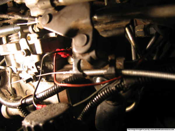

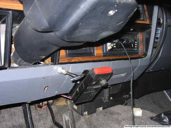

Pics for you guys :-)

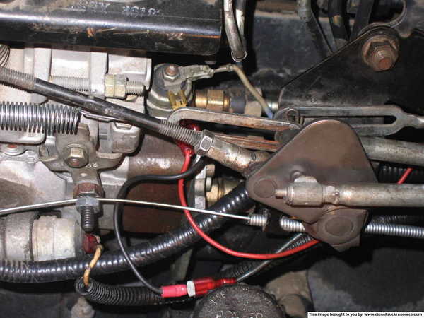

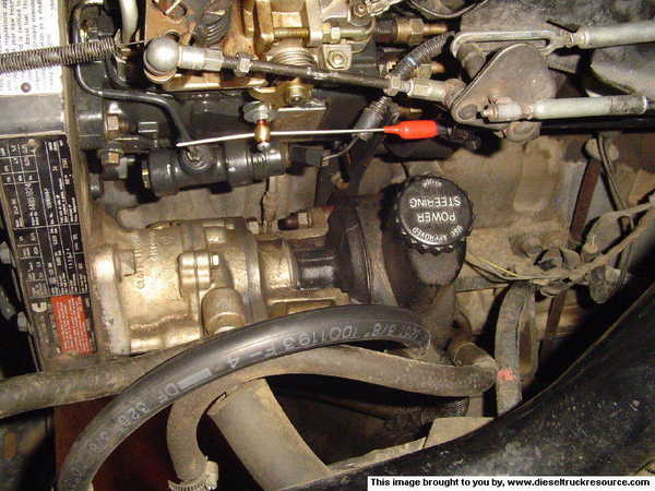

That cable is very close to the one I used. Here's some shots of mine. I don't want to drill any holes in any of the panels though, so I'm going to fab up a bracket to place it close to where I have it now.

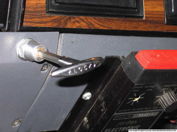

here are some pics of my pullcable and another idea as to how to hook it up the hook up is mounted where the hood latch puller used to be, but then it broke and now it hangs behind the grill, ill attach the images next

i used normal choke cable 72" or something of that length from canadian tire, not sure what you have there, but i just used that and dug into the bike parts for the cable clamp type of set up on the shut off solenoid, and another bracket near the back to hold the cable, the parts from a chevy truck, not sure what the part was used for though.
