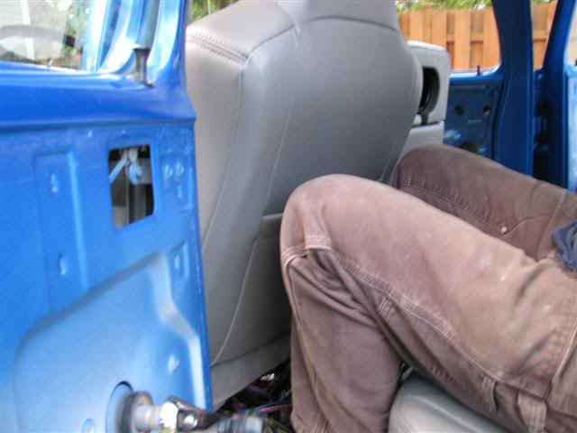

johny, do you have a side veiw of the back seat to show leg room. I bought a set of 3rd gen power, heated, leathers for mine. How did you mount the rears. I've got some ideas, but have picked one yet. I'll hopefully have mine mounted up by the end of the month.

oh i have about 8 hours in to the rear seats , they were a lot of cutting/ plating because of the angle of the rear floor , i'll get some pics tommorow

Old Sep 3, 2009 | 12:00 AM
  #146
johny5's Avatar
Joined: Oct 2008
Posts: 156
From: langley bc canada
Thanks guys....

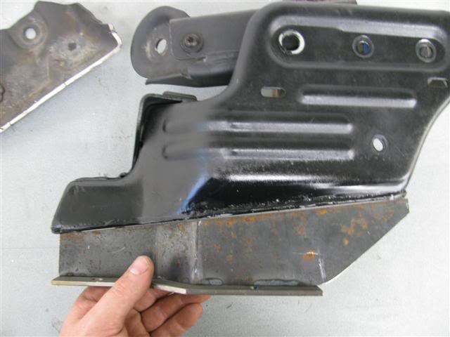

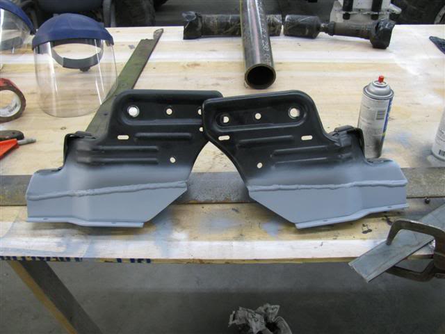

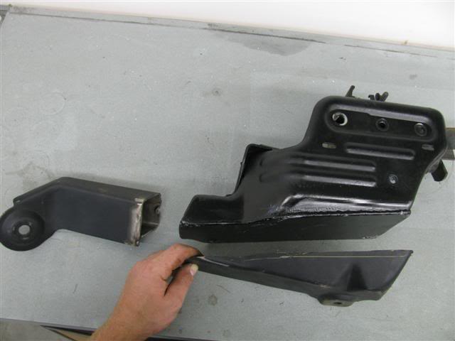

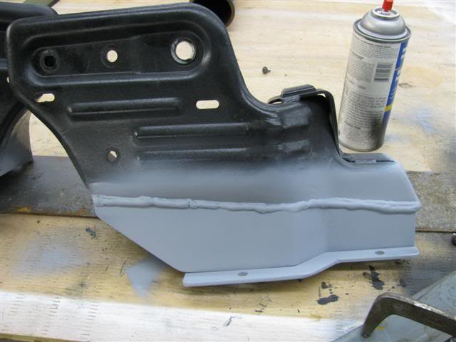

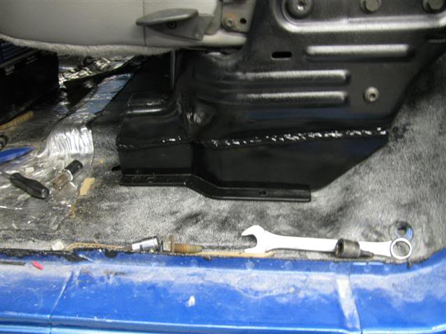

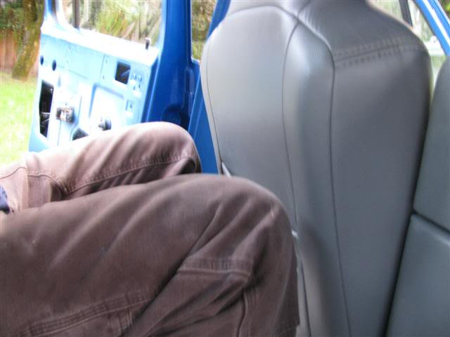

Here's some pics that were requested about the leg room and how I modified the mounts.

Thanks johny. Looks like yours were easier to mount then mine will be. The 3rd gen rear seats I'm useing mount at the very back of the seat, so I have to mount them on the hump at the back of the cab.

I looked at some 3dr gen seats and the rear seats were really short that's why I went for the ford seats.
