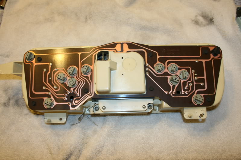

Wow,
I do not see it anywhere unless it is under the plastic cover over the speedometer but there does not look like there is any electrical connections to the unit.
Seems odd they would use unregulated voltage for the insturments.

Looking at that picture, do you have the same gauges as the '91.5 forward, but with a mechanically driven speedometer?
That is more or less what it looks like to me, but then '90 would be a really "odd-ball" year for the instrument cluster . . . I thought most of the transitional electrical stuff happened in 91.5.
Sorry, this probably isn't helpful for you, but I'd like to get a handle on these year to year variations.

I have the VDO electronic speedometer head,
I'll see if I can check some voltages at the cluster.
