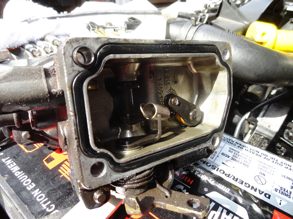

Today I had a few hours to kill, so I decided to take on my 3200 spring. It took about 5 hours total, as I spent about an hour and a half looking for that little spring that fell out of my hands that the 3200 spring attaches to. I tell you that my neighbors could hear me screaming obscenities for the entire time I spent looking. Consider I dropped it once, and found it, then dropped it again ! I was losing my mind, but eventually it popped in my view, and I never let it go. It was a real PITA to get the cover back on, but I figured out that if I backed the power screw flush with the interior of the cover, it went together with little fuss.
I can't stress this enough.... DON"T LOOSE THAT SPRING !
Here's the new spring in it's place...
The end result??????

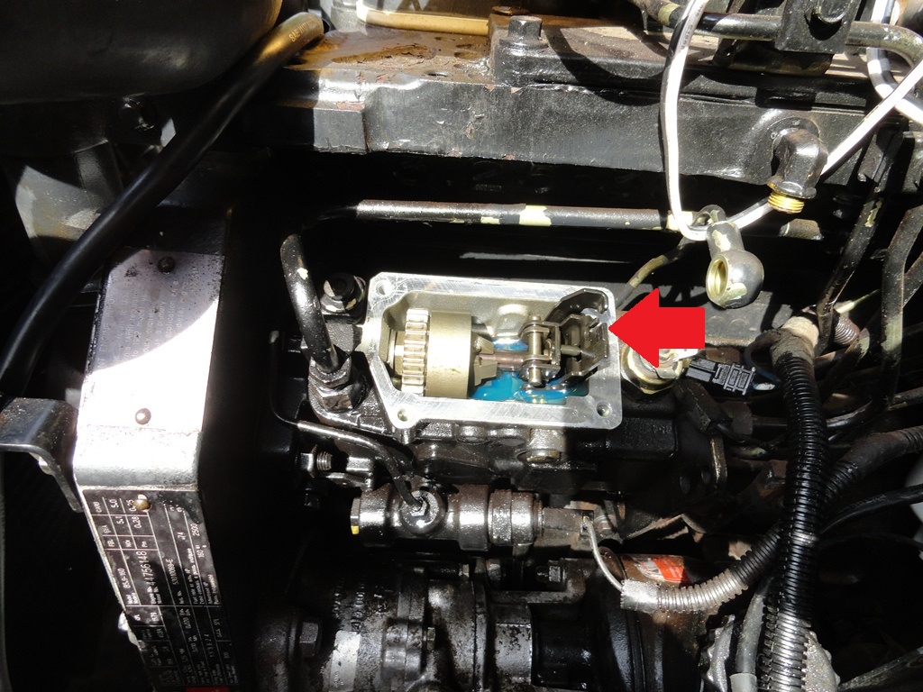

I pulled each throttle adjustment screw out, cleaned and lubricated them so that I can easily change the throttle stop positions. I removed my power screw cover, clamp and fixed the damaged threads on the screw, and cleaned and lubricated what I could. I had to adjust the throttle linkage as well, as my RPM's weren't were the were supposed to be when I started it back up, so a little fine tuning made it purr. I still haven't messed with the power screw, or any other mods yet, as I'm so pleased with the results as is. We'll see if Bill is right, and that only lasts a little while, as I fall off of that slippery slope, or not.
It took me forever to get the cap back on, as the lever inside the pump put so much pressure on the power screw, that I couldn't get the cap lined up. I fixed that by cracking loose the power screw nut, backing out the power screw till it was flush with the cap's casing, put the cap on bolted in place, and put the power screw back where it was when I started the job. Much easier.
I also, at Bill's recommendation, followed the sticky, and removed the bracket to gain access to the FSS, ground the rubber concave plug flat, and put the FSS back in place after cleaning the connections and lubricating the connectors that attach to it.

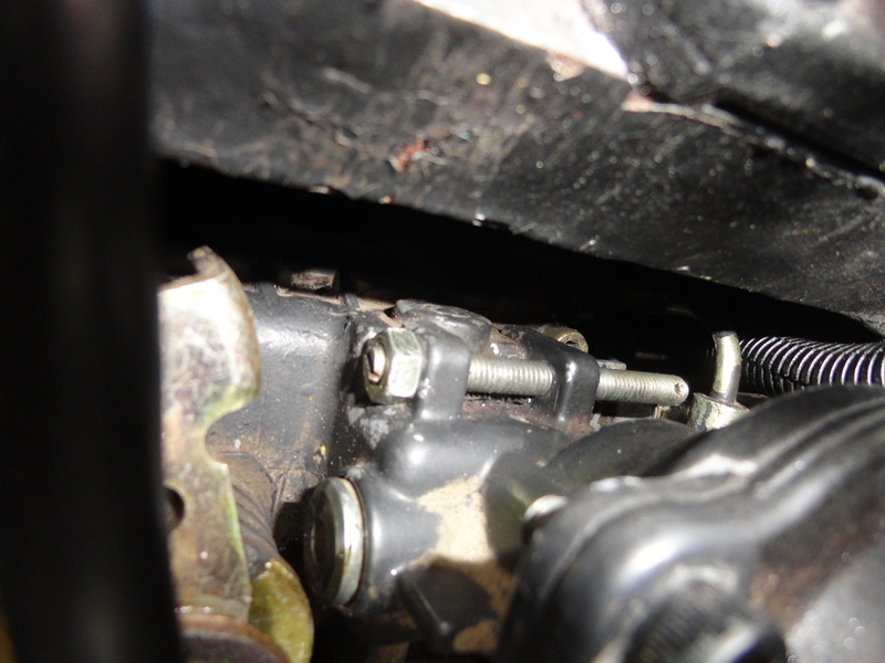

Any of you guys move your nut to the outside, like I did ? I also put a slot in there to be able to move it with a screw driver as I saw someone else here did in a previous post
