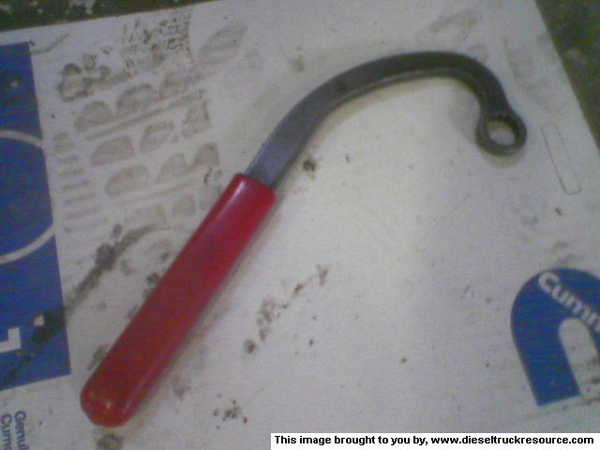

HEY!! wasn't somebody supposed to post a pic of their home made "S" wrench??

I just posted a picker of a home made "s" wrench that has served me and a couple other members well. It doesn't look pretty, but I haven't broken it yet. Must wait for admin. approval..................Dave

Approved.
Old Oct 24, 2006 | 07:03 PM
G1625S's Avatar
Joined: Mar 2004
Posts: 4,767
Likes: 5
From: port crane, NY
posted

Snap-on version!
Old Oct 25, 2006 | 06:00 AM
Trebor's Avatar
Posts: 1,167
From: SW Pennsylvania - Greene County
Thumbs up
I figured I would be using it more than once so I bought the Snap-on wrench.
It works just fine.
