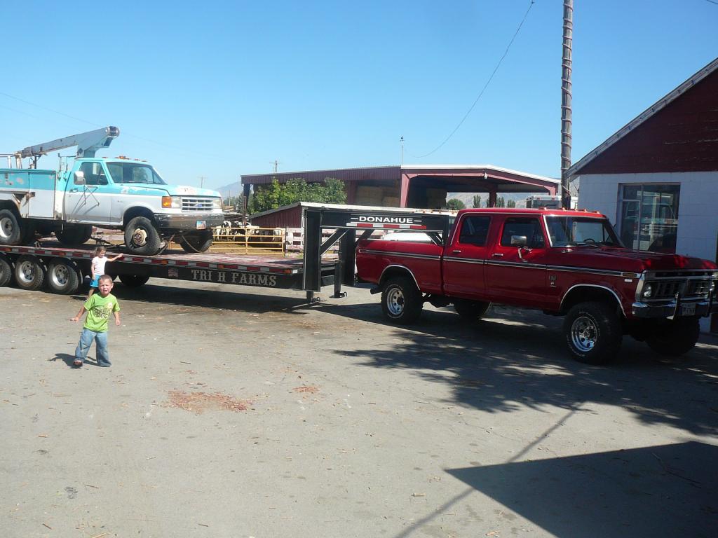

1st gen cummins powered ford towing 14k. a smaller quik spooling turbo will get better fuel economy. i tow in the mountains and ave. 16-18 if towing in the 6000 to 8000 lb range. 12to 16 k + truck puts me over 20k get 13 to 14.. this is high elevation. power is no problem , proper set up is key.
