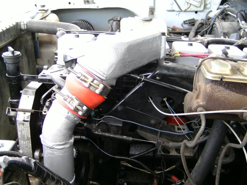

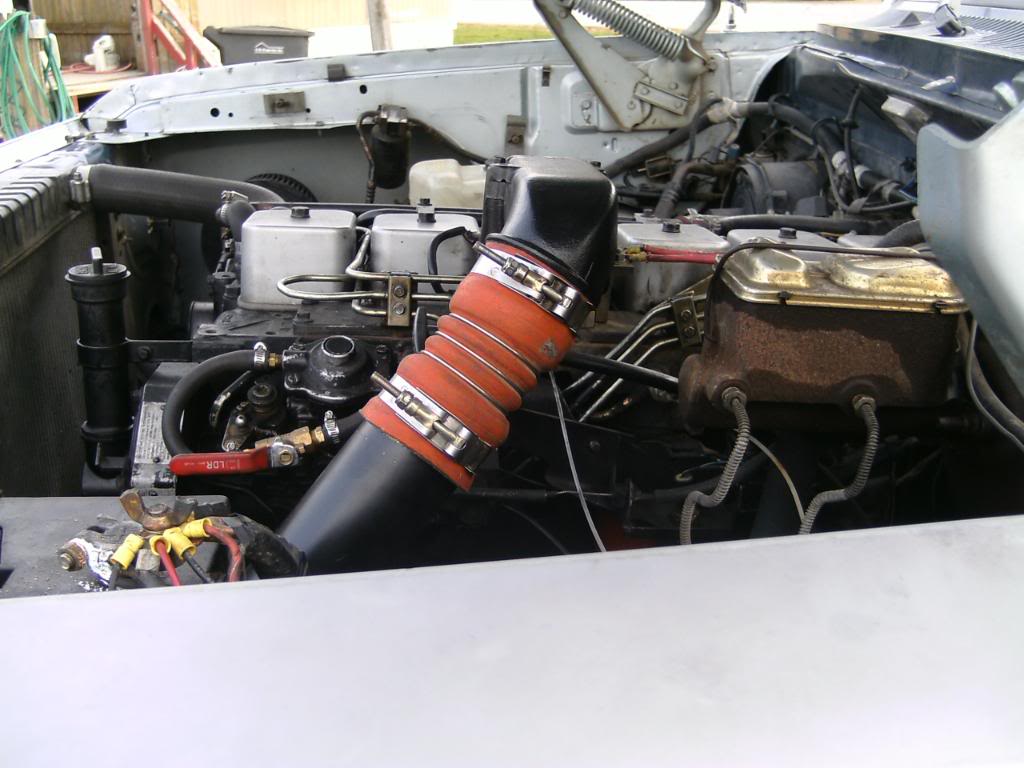

The I/c and N/Ic'd plates are different but you can do like I did and flip your N/Ic plate 180* to clear the M/C. When you do this your N/Ic throttle bracket wont fit right and there will be no way to fasten it on the top as the 24v horn is much taller. I finaly ended up going with I/c throttle bracketry and lines so it all works right
Here are some pics
This is with a 2nd gen 12v horn you can see the throttle bracket just dont fit right

This is with 24v horn and I/C 1st gen lines throttle bracketry and "special"I/C DVs and holders so the line fit
