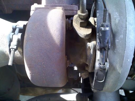

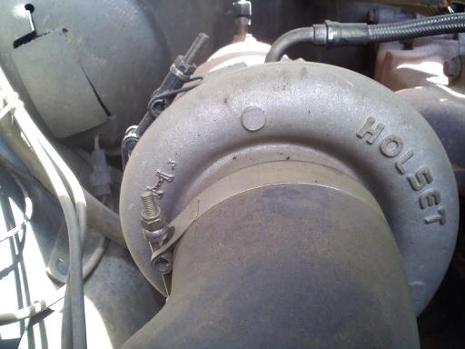

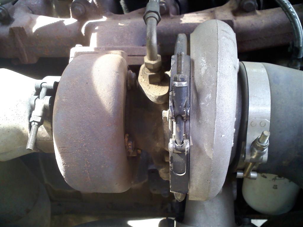

Old Mar 25, 2009 | 09:35 PM
93-12Smoke's Avatar
Posts: 1,751
Sorry it took so long. Got a couple more if needed. Sorry if the quality is poor. All I had was my cell phone.
Attached Thumbnails Help identify Holset turbo-turbo.jpg   Help identify Holset turbo-turbo-2.jpg   Help identify Holset turbo-turbp.jpg
Old Mar 25, 2009 | 09:47 PM
jimbo486's Avatar
Posts: 4,389
Likes: 114
appears stock to me. i know the '92 models came stock with a 22cm exhaust housing. possibility of an 18.5cm h1c exhaust housing was mated to the center section? but even with an 18.5cm housing, egts shouldn't be too high should they?
Old Mar 25, 2009 | 09:51 PM
Mattster's Avatar
Posts: 515
From: Port Orchard,WA
Possibly has an upgraded compressor housing.
