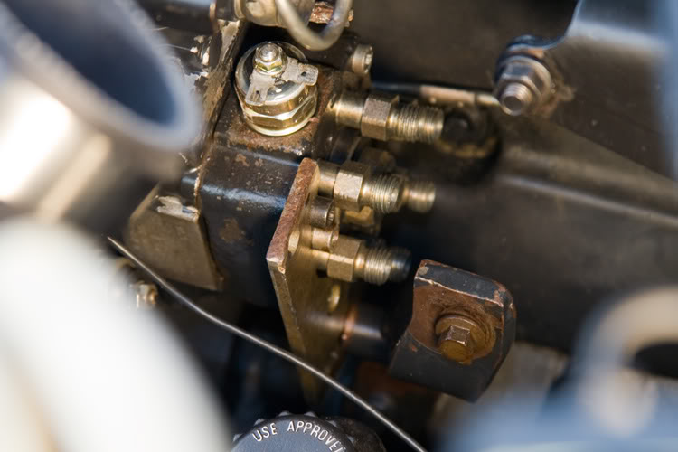

See the round fuzzy thing top left? The fuel solenoid is just to the right. On the injection pump, just above the fuel injection lines. It has the two 1/4" push-on electrical connectors held on with the single nut.

Removing it can be a pain.
Be sure to remove the electrical connectors to start with.
If you've got a slender crow's-foot wrench, that'll work . . .. sorta.
I've found tapping the end of one of the flats with a punch and hammer will get it moving. It's sealed with an O-ring so once you get it around a turn or so, you can finish it by hand.
If you look closely at the above image, you'll notice I cut that bracket out of the way. That gives much more room to work with.
Hope this helps.
